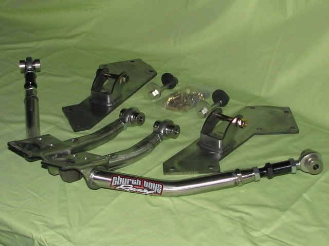

You can also try these they will stiffen up the handling and down the road they are compatable with the Church Boys rack/pinion conversion.
Here is a photo of the whole Church Boys rack/pinion kit before the installation.

I'm not sure if you are referring to my kit or not so I'll speak up. Not everyone needs a column replacement, and not everyone buys the tubular crossmember. Some people even use the kit with the rear mounted strut rods as well. All this chips away at the final cost, and yet, gives you rack/pinion steering.
Like I mentioned you can use the tubular lowers by themselves to improve the steering and handling with the stock steering still in use. You don't need to purchase the whole deal to get improvements you can do a little at a time.

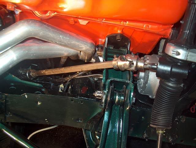

As VoodooII stated our kit uses the stock front end with its factory sheetmetal. A very good header for your application is the Hooker Super Comps #2243 here is a picture of them on a car with the stock lower control arms and rear mounted strut rods.
