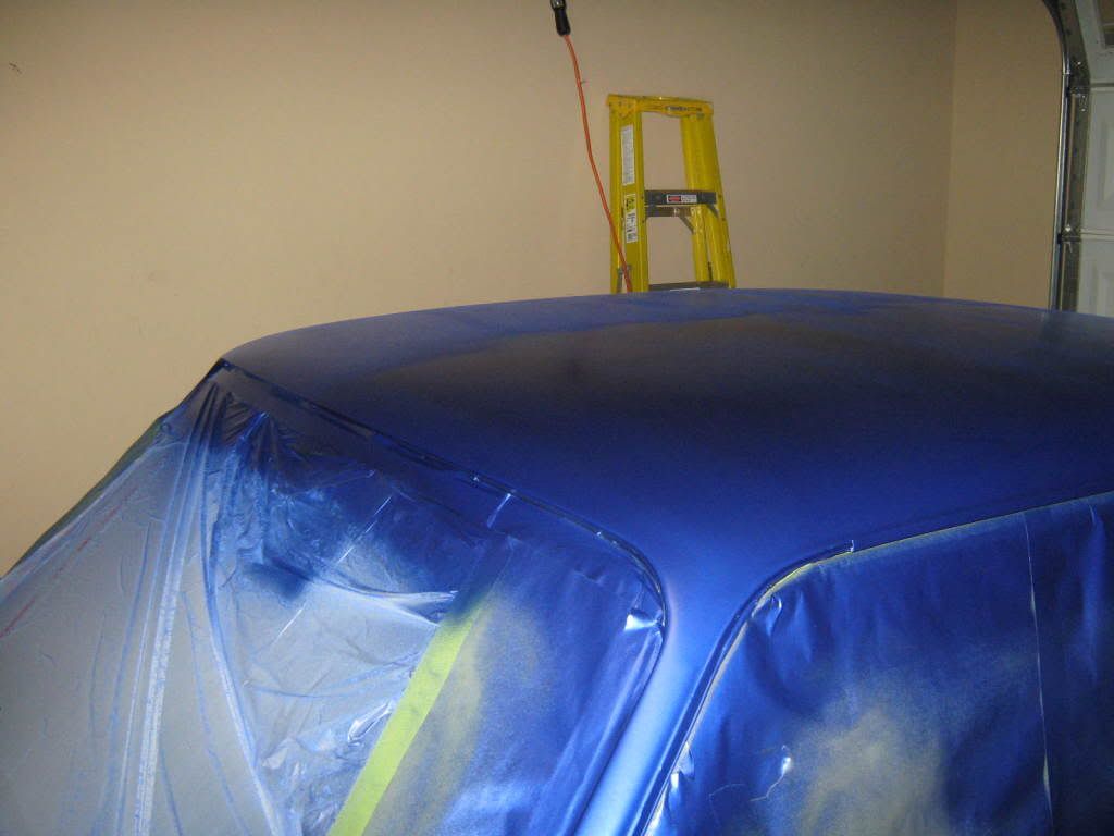

I got the sealer and base coat on today. The paint is laying down nice and smooth but I have another issue on the roof and trunk. It looks like I have stripes in the paint. I'm making my passes as consistant as possible, holding the gun about 6 - 8 inches from the metal. Is this just a difficult color or is it me? The color is Deep Blue Pearl Metalic. I have three coats of base and plan to clear it tomorrow.

I was having that same problem with my blue:yes: I sprayed in different directions, try going across the roof and from corner to corner to even it out, it worked for me:)
I can't reach all the way accross the roof. The trunk lid looks similar and I was able to go all the way accross.

It is best not to crisscross, unless you are really good at it. I do all in one direction overlapping and than stand back and fog mist the entire area. That is one way of masking tiger stripes. I am not a pro. Have fun and do not let the sweat get on the paint.
Keeping the sweat out is a challenge. What do you mean by "fog mist." I was thinking a final light coat, holding the gun twice as far and moving it twice as fast as my coverage coats.

How much overlap are you doing with each pass. With a metalic or pearl, you want at least a 50% overlap and better yet a 75% overlap. Thats what I did on my pearl orange and it came out pretty good.

My final coat was a 75% over lap.

Try doing a 1 second test shot........a 1 second pull on the trigger with the gun 8" from a test surface like a piece of white paper hanging on the booth wall. Check you paint pattern from this test. If the presure is correct and the fluid setting is correct, you will have a very even oval shape (really like a rectangle with rounded corners. If the pressure or fluid settings are incorect, you will have more paint at the edges than the center or vice-versa. If that is the case, it is very hard to get a nice even coat on your car. I think you might have more paint at the edges of your pattern than in the center. I took me a long time to get my gun set right. But once it set right, it makes things a lot easier.

The tiger stripes are fixed and I've got the car cleared. It's looking shinny. Still not perfect, but much better than my first try. I'll post pics once I get the hood done and on the car.
