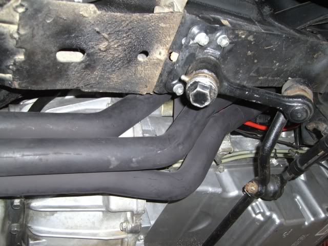

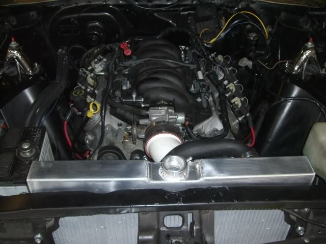

Here is a car I just finished Ls1 auto with stock front end. We made long tube headers to work with stock front end. And they say it cant be done!!!:yes::yes:

Looks like possibily LS? headers with number 1 and 2 tubes taken from a set of Nova headers and grafted part way down the header.

Looks like they were fun to install. How'd you do it: lay the headers in the drop in the engine, or install from underneath with the engine already in it?

parts and pieces
pan is 04 gto, the headers are ls flanges with long tube header kit, and misc tubes from a chevy II long tube header, to get them on you have to lift motor up and install from the bottom. They are 1 3/4. Car is a members car he will soon have it back doing burn outs I am sure.:yes::yes::thumbsup: He will have a complete thread of the car as soon as they(he or she I cant say I promised silence till he gets it back) get the car back. It came out really nice. It is the perfect car for the swap.

Wow, what a nice job! Thanks for the thread, and I'm looking forward to the complete thread. What auto trans. did you use, a 4L80E? Did you have to modify the trans. tunnel?
Thanks, Ed

trans
4l60e no mods needed to go with the auto only the 6 speed you need to clearance the tunnel. They wanted the car to appear stock so we kept the shifter on the column so at first glance with the hood shut you wouldnt expect an ls1 in this old girl. The car is my favorite one I have done so far (14 and counting with the ls swap) The dash on the underside was so clean it looked as if the car was put together yesterday.

The headers clear pitman arm like they should. They are snug in 1 3/4 so the sets we are going to make are going to be 1 5/8(plenty good up to 750hp). Thanks for all the compliments.
