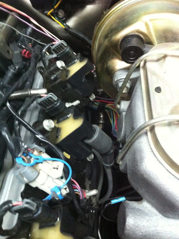

with the booster setup I'm running, the #7 coil pack hits the booster. So bad that I actually broke the coil pack while dropping in the motor for mock up:(
I think that the "F" body coil pack brackets kick the coil packs forward at a 45* angle, I wonder if that would work??:confused:

Mine are F-body type, and from what I can tell in your pics, they look the same as yours.

I removed my Coil pack, Then removed coils. Cut open the square that the coil sits in to the side and up about a half inch. THen made sure it would clear the booster. drilled bolt holes and welded nuts on the underside. Now its all good and cost zero..

Fbody coils are not the same as those, fbodys have a flatter coil. They may clear.
