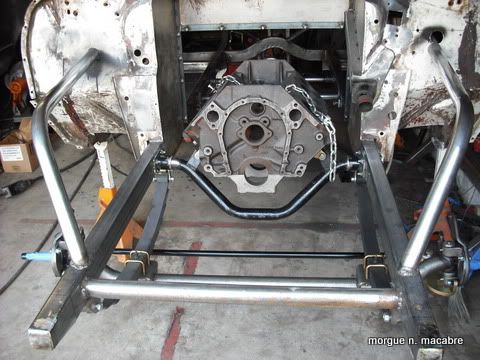

Got the steering gear mounted. With a lot of measuring,I was pleasently surprised how close the pitman/tie rod is going to line up. I'll will have to bend it a bit to have it work,but after looking at a lot of photos,this would not be uncommon.
Plus,I like where the gear ended up,but building headers just got a little more exciting.

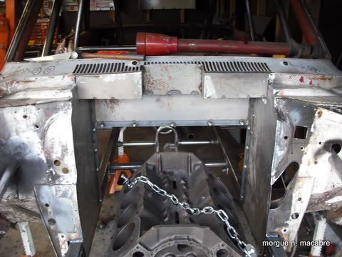

So today I trimmed and welded the inside doghouse to frame.Plus put in gussets over the seams of the frame rail.I also welded out the rest of the notched out area and ground away until I got tired. Still need some more grinding.Hopefully I can get all the holes filled and ground,then clean the firewall area and get it in primer.

So after a nap,Tara and I went back to the shop.I needed her to hold a peice of brass on the inside while I filled holes from the outside.After that,grind,grind,grind. Was out there till 10 pm. Really enjoyed a nice summer Sat. night. And all the holes are filled now.
