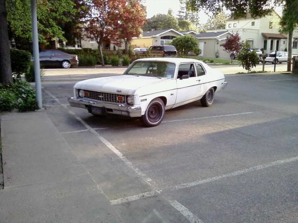

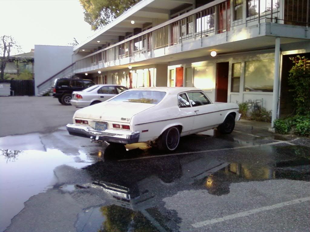

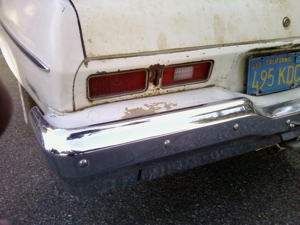

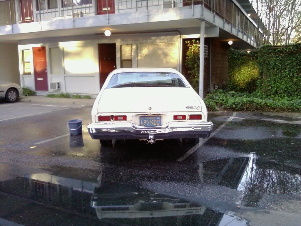

And just for the sake of having a build thread, here are the pics of our first day with the car. (Sorry about the cell phone pictures)

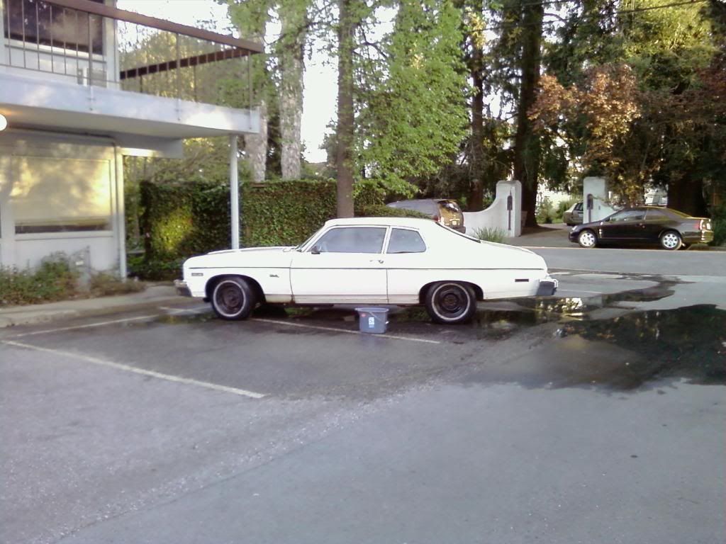

how I found her

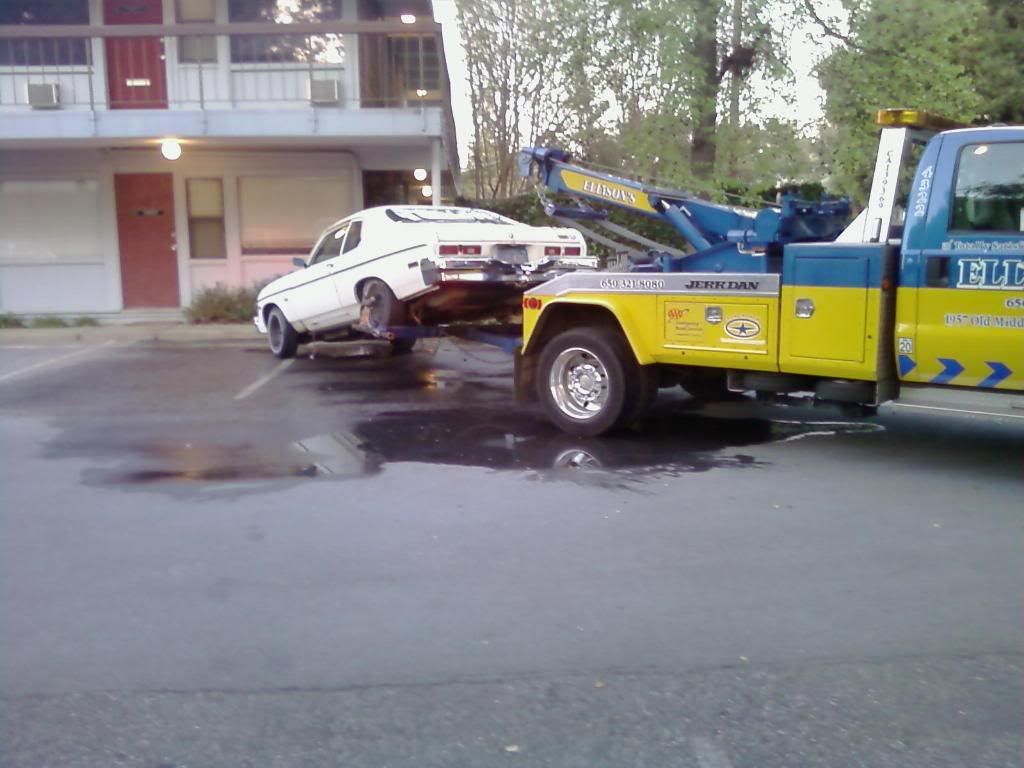

after a quick wash at work, waiting for the tow truck

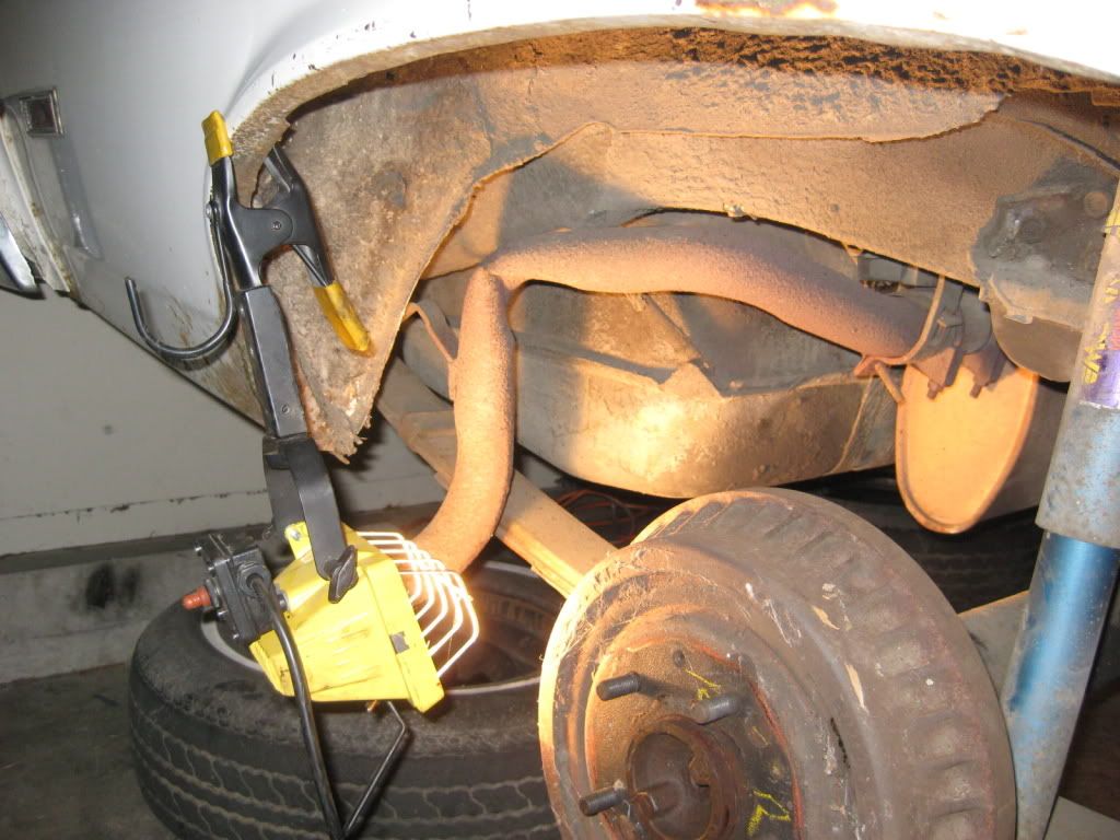

and the worst of the rust

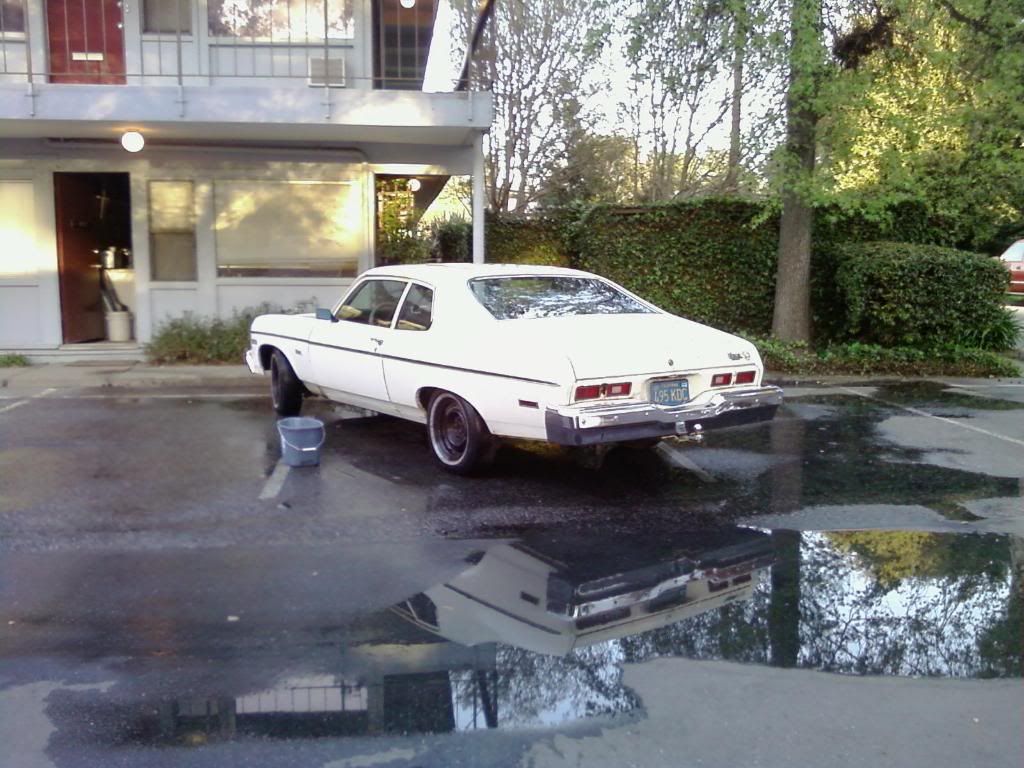

On her way home

Rust in the bay area is probably typical, especially if the car has been very close to the ocean for extended periods of time.

Last night a buddy came over and helped me with the brake issue. We discovered 2 leaky rear wheel cylinders, which we repaired and bled. The pedal was still quite spongy, and it looks like the master is DOA. Not a big problem, since after bleeding the front drums, I don't ever want to have to mess with that poorly located bleeder screw again.
In addition, the front shoes at some time in the past were worn down past their rivets, which gouged both drums. New shoes were put in at some point with the damaged rotors, so now the shoes have the same gouges in them. So, I decided to say screw all that, and ordered the disc brake conversion kit with brake booster and master cylinder from Summit, along with some 2" spindles, since it will all be apart anyway. I decided not to go with the Ebay kits, mostly because I want to be able to go back 2-3 years from now and find out what rotors/pads I'd need to replace them, etc. That and they ship really fast. I'll post some pictures once the stuff comes in.

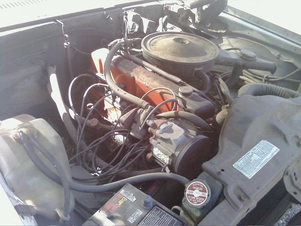

Anyway, here are a few pictures from last night.
Here's a couple horsepower waiting to be unclogged... any suggestions for a louder but not obnoxious muffler?
Leaky wheel cylinder unchecked for who knows how long...
FUBARED front shoes and drums
I have a Raptor muffler on mine and it sounds pretty good. For the record, I too have a '74 more door with the I-6.:D

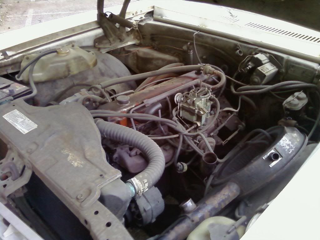

Better pics?
I did not get to see the original ones you posted. It seems they got deleted. Please post some more. It'd be nice to see what you're working on.:yes::D
I fixed the pictures. Sorry about that. I'm starting to like the idea of sticking with the 6 cylinder, but it just seems so far off before I'll be able to afford to rebuild the engine. Gotta get it road worthy first. Should I be doing other suspension/steering stuff while I have the spindles off during the brake conversion?
