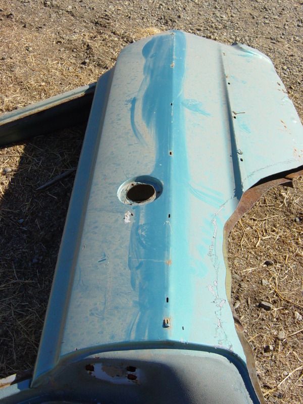

I need a pic of a 64 400 series wagon driver side quarter
1557 Views 9 Replies 4 Participants Last post by  novaBRO
at some point someone installed a 63 wagon quarter on my car and I need to drill all the trim holes in it:yes: I was hoping somebody had a pic of a quarter without the trim installed so I can see where to drill:yes: I don't want to just copy the other side because the Driver side has the filler neck on it and I think the location of the holes may be a little different:yes:

Ryan, I worried about the holes in relation to the fuel filler neck.
Mike, did you find what you needed? I had a 64 wagon qtr here and took the measurements off of it.
From the rear of the door opening the holes/slots are centered on;
1.5,3.5,12.5,21.5,30.75,40.125,50"
I have some pics but need to dowload them to photobucket if you need them.
Hope this helps.

that's great, thanks Ken:yes: the picture would help too if it's not too much trouble:D
you got the measurements from a driver side quarter right?
Here you go.
I'm guessing it is a 400 series? The slots for the moulding are about 1/8" above the body line.
3
Here you go.
I'm guessing it is a 400 series? The slots for the moulding is about 1/8" above the body line.
yep that's it! i won't be able to replicate the same holes to be able to use the bath tub clips:no: I'll just dill a regular hole and see if I can find some kind of snap in clips:yes:
