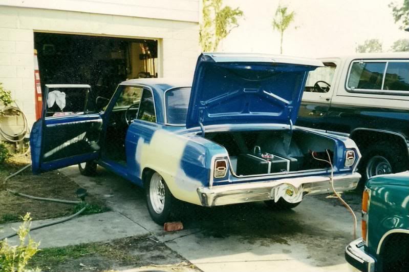

I fit a 26x10.50 on the back of my 64 without cutting, tubing, or even moving the springs! I doubt the 28" tall tire would fit without cutting the front of the wheel well opening or moving the axle back a little.
Here's a couple quick pictures!
