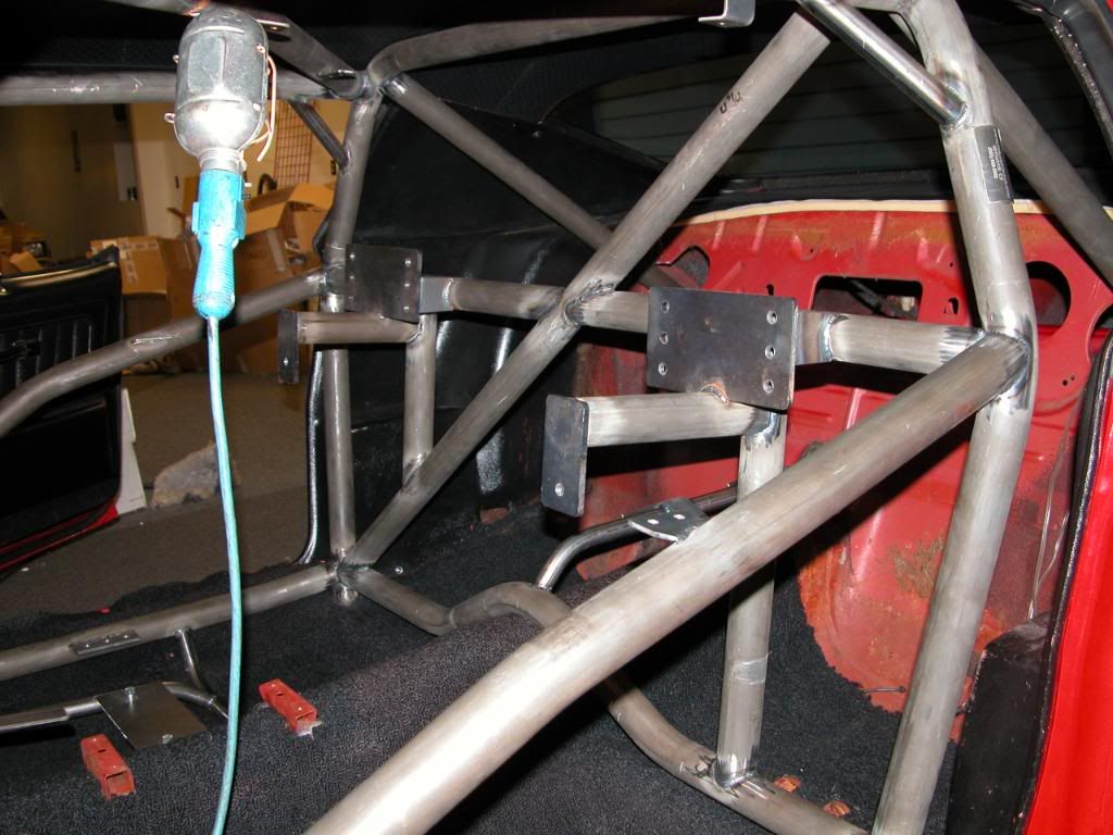

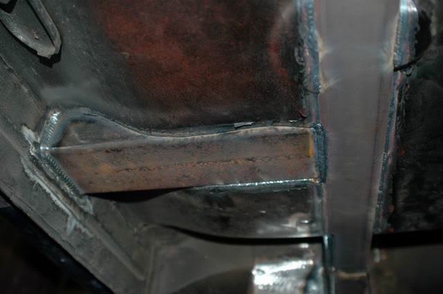

I just had a chromo 6pt bar with door swing outs and frame connectors done in my 67 Nova. I wanted an 8pt but the Chassis builder suggested a 6pt with the out riggers. I paid under $1800 for the work. I'll post a pic of the swing outs shortly for you....

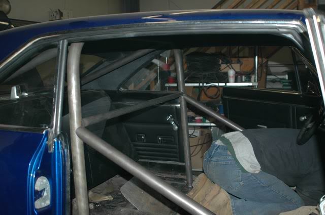

Although not a nova I just had this done over the winter. $4,500.00 included cage, firebottle mounts, full containment seat mounts, modding seats, harness mounts, and fabricating front and rear tow hook provisions.

I bought 3 sticks of 1.625 X .134 wall from shaprio supply for 120 dollars cash. Then I borrowed a friends bender. I found the radius of the bender then made some circles of that radius out of plywood, then made some wood strips. I cut and screwed it all together to determine where the bends should start. It is a 10 pt. and I am happy with it. It only took me 1 weekend to fit it all up. Oh yea I also used my bridgeport to cut the bars, but a drill press will suffice.

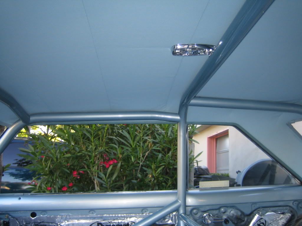

The guy that built my cage did an excellent job matching all the pilar and window angles.
pics:
4
pics:

wow thats nice! i like how the painted it.. Im working on the my car this summer.. im putting all my cash into her
Dang that looks VERY beefy!
