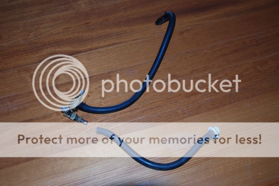

Looking to replace the hoses and clamps in this pic
this is the pcv hose that i found at napa that i think is what i need

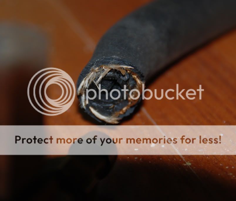

But the brake hose to the booster looks like there is some metal tubular core inside the hose along with the insulation. What should I replace that one with? Also should i replace the clamps with the same style or a threaded clamp?
heres a pic
13,309 Posts
when you go to the parts house.... tell them you want vacuum hose..... dont let them sell you fuel line hose.. fuel hose line will collapse under a vacuum.....
