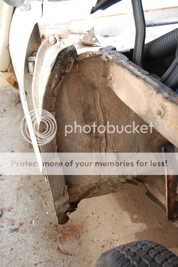

After removing a fender I had a few questions.
What is the sealer material (the vertical strap w clips in it) thats is between the fender and body? Didnt know whats best to replace it with.

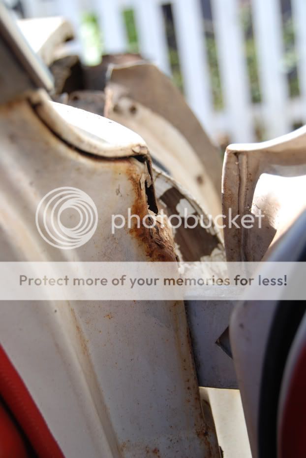

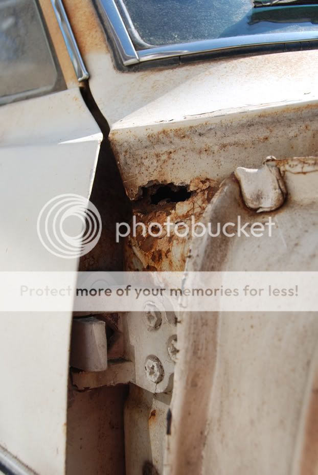

Whats the best way to patch this hole for a newbie with no welding tools or experience? Should I take to someone to fix?

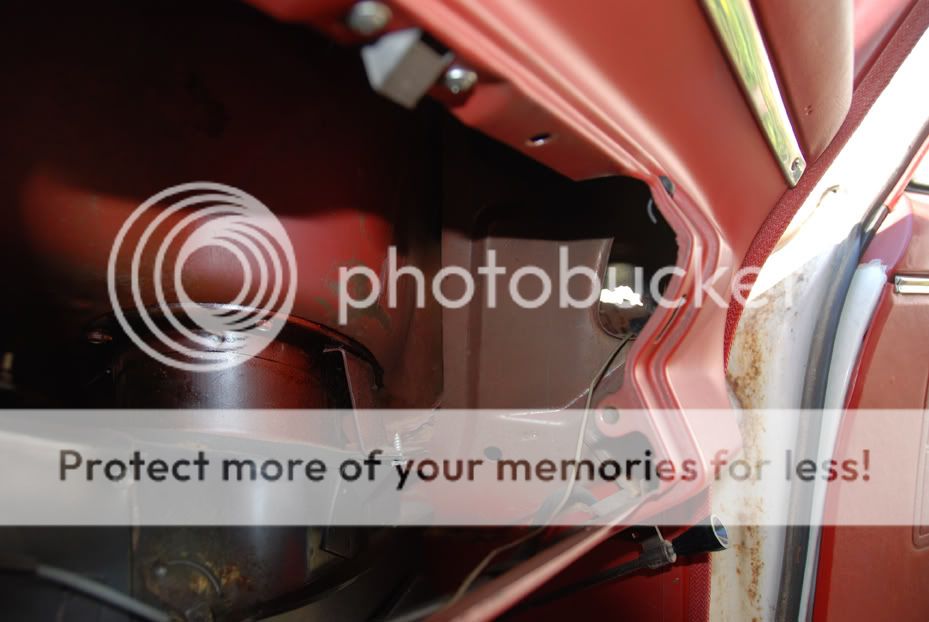

heres a view from inside the glove box

the right way to fix it is to cut it out and weld it:yes: buuuuutt.... if you want to get a little red neck you can clean it, paint it with POR15 then slap some fiberglass bondo over it, sand it, prime it, paint it and call it a day:D
I've done it before and repairs 10 years old still look good:rolleyes:

Eastwood company has the seam sealer you are looking for. They have a product called "Seam Sealer Brushable Quart Item #31028". It's like the factory sealer.
For the rust hole another alternative you can do is "No Weld Panel Repair Kit
Item #31102".
Hope this helps

So does that mean that I wouldnt need the strips that are held on by the clips? Looks like a gasket or something. Might be hard to tell in the photo but running vertically are clips holding a seal of some kind of material.
4,125 Posts
You should really replace that seal. It's a mud/dust shield and is meant to keep crap from getting back inside the fender where you can't get to it to clean it.
491 Posts
seals
I put new seals on and used stainless steel screws instead of staples. Worked pretty good.

Bondo help
I know this is ******* but I'd like to at least get the bondo part right:D
I had left over por 15 prep materials and paint so I prepped this area and put a coating of the engine enamel.
Then I read the Bondo can where it says to get it all down to bare metal first :(
Will Bondo adhere properly to this red Por 15 paint?
If it does, I bought the kit with the wire mesh swatch that I was going to crack, peel and stick it and mix up the Bondo and slather it in.
