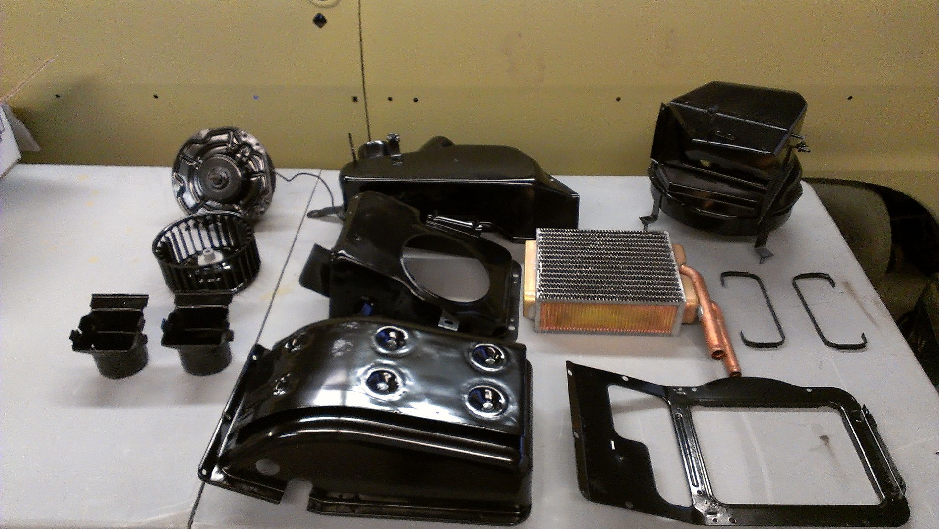

I thought I was gonna swap out my heater core on the wagon ,should be quick job about an hour right :confused:
yea right :no:
after I removed the heater box I found about a 1/8" of rust dust in the bottom , so I blasted and painted all the components for the heater and defrost
two days later I have a completely rebuilt heater , with all new seals
weatherstrip , vent hoses ,
it gets nice and toasty now :yes:

Ok, so what did you use for the seals? I'm doing the same thing and NEED TO KNOW!:yes:

Could you take photo(s) of assembly .....???
already in the car ,I might be able to do another
I had some 1/4 dense foam sheets , you can buy them at a crafts stores
I bought a roll of 1/8' to do my kick panel vent seals
