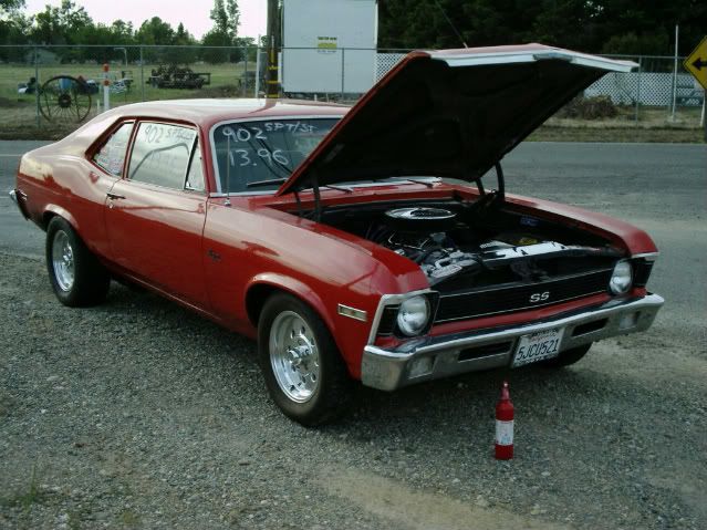

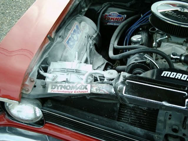

Driving home from the dragstrip on 5-9-09, my water temperature started to rise, and as I pulled to a stop sign, the inside of my car filled with smoke, and when I stopped, smoke was billowing out from under the hood. I opened the hood, and there were flames a foot high if they were an inch. Grabbed my fire extinguisher, and put it out. In theory, I could have just as easily put it out with my shirt if I had too, but at the time I thought it was a lot worse.
Basically a wire for the electric fan melted against the radiator and grounded out, which of course stopped the fan, and began melting the plastic covering on the wires all the way back to the battery, and caught the wire loom on fire.
Fixed it all today. Looks awesome, and no wired are touching the radiator!
That crap gets everywhere.

No fuses in that line that shorted?
Good to hear the damage was minimal. It can be really devestating. You need to get a fuseable line or circuit breaker or something protecting that circuit.
