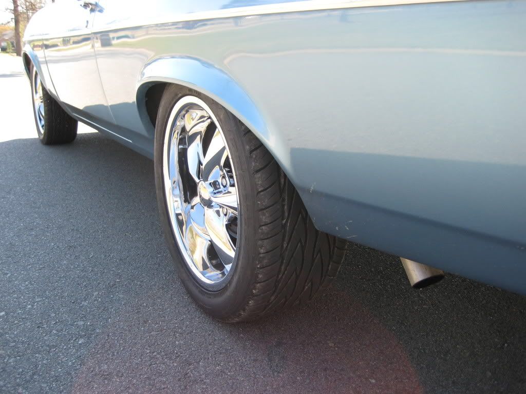

I used almost the exact same tire/wheel combo that Scott (sporty4680) put on his 1970. Wheels are Foose Legends and the tires are Toyo Proxes 4's. Up front I put 17X7 with 4.25" backspace 235/45R17. The rears are 17x8 with 5.25" backspace 245/45R17.
The fronts fit like a dream and actually turn easier than the stock wheels I had on there. I beleive I could lower the front a little. The rears don't come any where close to the fender lip. They do how ever come a little close to the inner fender well. I don't think I would want to try and lower the rear and may have a problem with passengers riding in the rear. The seller of the wheels tried to talk me into 4.25 bs for the rears. I am glad I listened to you guys.

We had it done at the local custom muffler shop. We just told them what we wanted and they did a great job.
I looked at your build page and that is quite impressive. How did your car sit with the 2 inch drop? I don't want to get it too low in the front.
· Premium Member
3,587 Posts
My Nova sits just about level, with about an inch worth of rake from front to rear. I have 1.5" drop leaf springs in the rear, and the 2" drop springs in the front.
If you change from your 6 cyl. springs to 2" drop Hotchkis, my guess would be that you would actually see only 1/2 or 1" drop. I say this due to the extra weight of the V-8 you have in there right now on the 6 cyl. springs.
Thanks for the exhaust pic!
