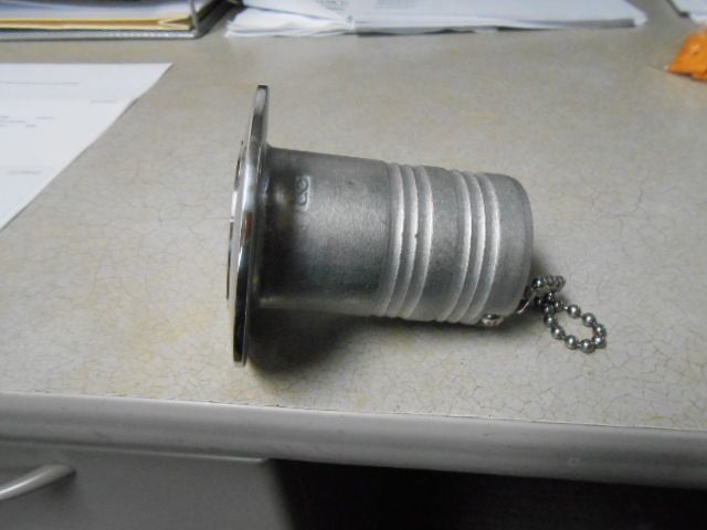

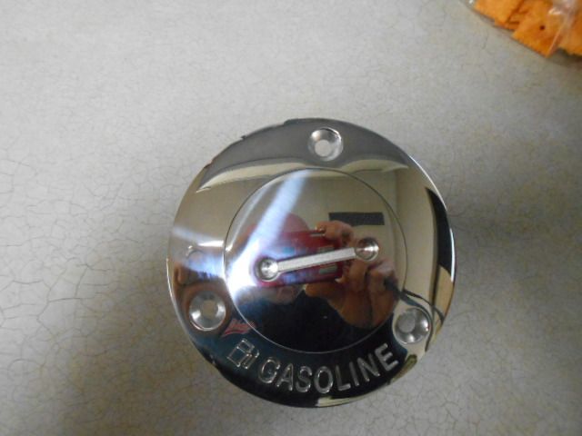

The stock diameter round outside portion on the quarter panel is 4 inches. The gas cap flange outside diameter is 3.5 inches and the portion where you would splice a hose onto is 2 inches round. Its a nice piece as well. Stainless steel and the portion that unscrews has a nice o-ring seal so when the car is garaged you shouldnt have that gasoline smell. If you hook everything up right that is!:D I will also ground mine with a strap once I do it. I just wanted to get the cap now in case I need to modify anything before I paint the wagon in the next couple weeks. Its a way good deal for the price and I think it will work just fine.

OK maybe I'm slow but how do you unscrew it? Is there a tool?
I just read the info on the site, there is a separate key you need to buy.

Then do you connect that to the tank using a hose?
I plan on doing something like this, using a hose plus the original neck. I will also use a ground strap in case of sparks when filling up with gas. The only thing I am unsure of is I am going with a LS engine (LQ9 6.0) and I dont know if it needs to be vented or a sealed unit? Does anyone know for certain?? 63LSWAGON, BURKE, CHUCK, NOVA 404 are you there??? :D
Miles
Yes they make a tool. I didnt buy one, in fact I may buy one..I think you could even have it on your key chain. Otherwise I have something I can use to open it. I am not going to utilize the chain that connects to the cap..due to I dont want it dangling and scratching paint!!:eek:
You will need to vent it as that cap is not. You running at return system?
Im not sure, Im not that far yet. What I have is a '06 LQ9 and I will be running the motor in stock form with the truck intake etc. Plan on using a Ricks tank or the new one as of recent..stock tank with the 2011 Camaro Fuel pump etc. What do you recommend?

If you run an in-tank pump you will need to vent it. I've never had luck with a vented cap. Rick's make great tanks, I own two, but you can probably do it for less.
Stock tank and throw this in, way more than you need:
http://bangshift.com/blog/efi-conve...e-easiest-fuel-system-youll-ever-install.html
