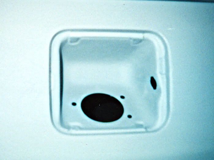

The door is from an 86 honda civic. Man thats some tough metal for being so thin. I liked the square look, coulda got a round one, junk yard special. The whole car is nuthin but straight lines, no round shapes cept the headlights. The square door compliments the lines of the car IMO. I was able to keep the remote cable which is routed up to just behind the drivers seat. JR
Honda inner bucket with door removed.

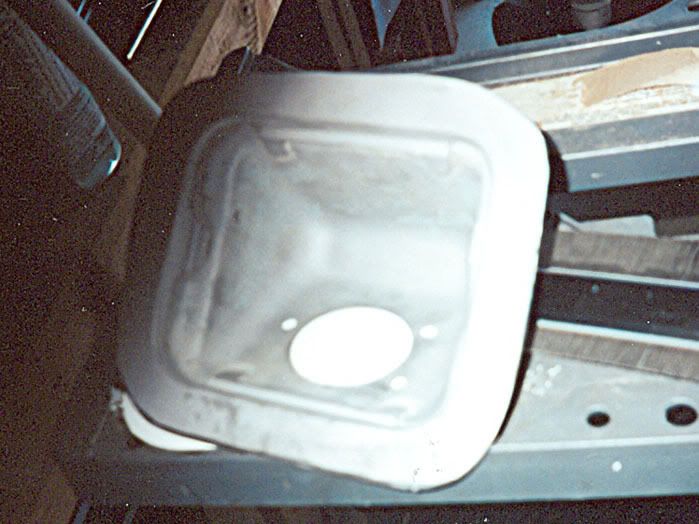

Cardboard template made from honda filler. Plasma cut old filler.

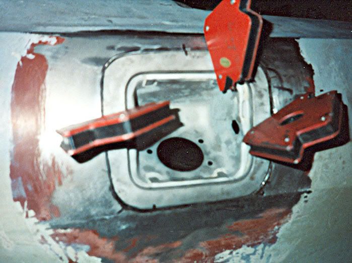

Old filler completely cut out. Test fit of new filler. It had to be shaped to the curve of the nova quarter, the honda was pretty flat.

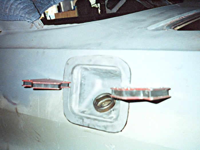

Ready to weld

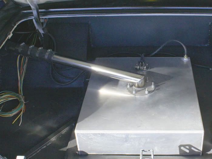

Inside trunk, fuel cell. Stainless filler tube.
Ready to weld
