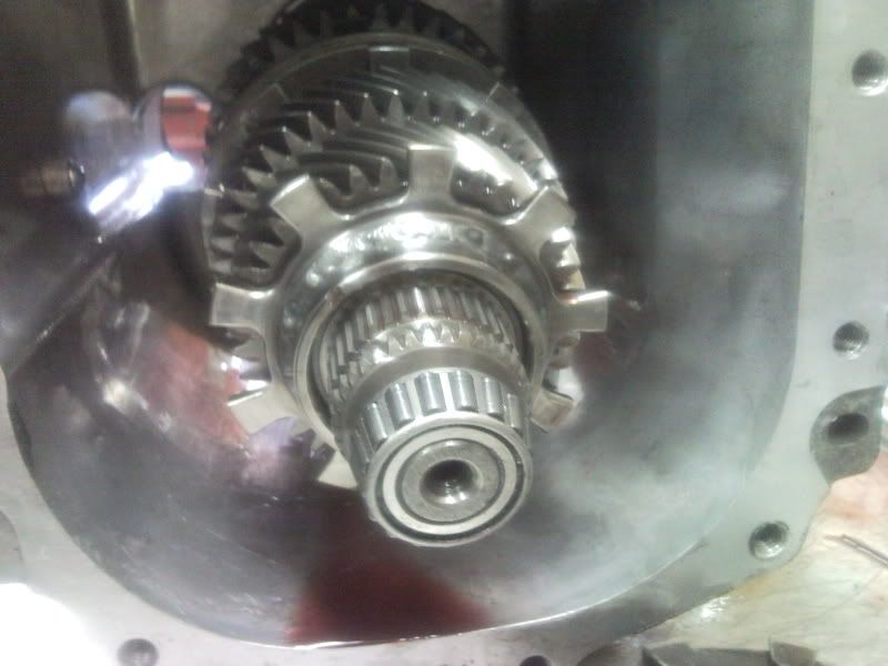

What it's supposed to look like:
What is wrong:

Looks like I'm going to replace all of the faceplates with the newer designed 7 lug plate instead of the 9 lug. The 9 lug are smaller at the base. the new 7 lug are wider at the base. New design: http://www.tick-performance.com/tickshift/images/faceplatebig.jpg
Would be nice if I could get the gears and plate made as one piece instead of the plate being welded on. Should be about $600 for the new set.
Had good traction. The track was prepped really well. Record were broken in quite a few classes. I had the two step limiter set too low at 4000 rpm. As soon as I launched the motor was dragged down to about 2500 rpm. Then the top end limiter was set too low at 7500. I think the second gear faceplate was broken on this run. The second run had a better 60' with a 1.66x, unfortunately I left in third gear instead of first. Spun the clutch. Tried to shift into second and no go.
Gears are going back to Liberty this week to have the plating re-done with their 7 lug plate and sliders. I hope to be back out by late April
