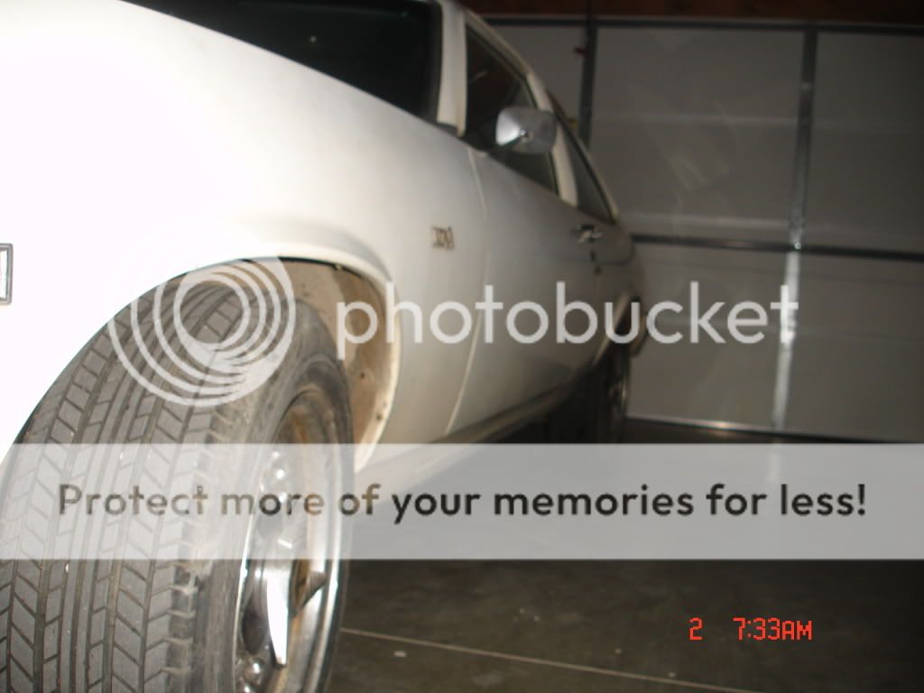

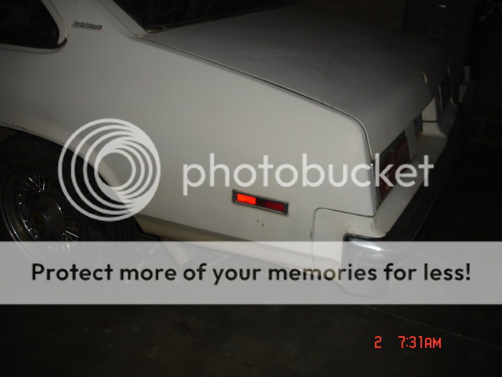

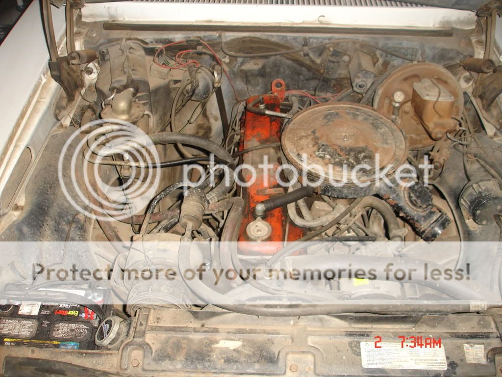

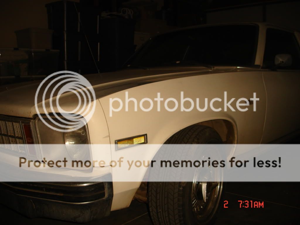

Well I've decided that my first ever car build would be a 76 nova. Now im looking for dedicated amount of help from a community as im not the savviest car person ever but I'm a fast learner. My plan is to put a nice engine (most likely a 350) a manual trans and other things. I have plenty of questions such as what motor will drop right in and if I wanted to put "x" motor what will need to happen, and how hard is it to convert an automatic to manual? how would I go about doing so? is there anywhere I can get replacement interior panels? etc.
Sorry for the complete lack of knowledge this is my first build after all :D
Thanks for any help in advance

Looks like you have some work ahead of you but the car looks solid. Take your time and don't despair if things seem to take twice the time you excepted them to. And yeah buy quality tools even though they are a bit more expensive.
Good luck!

Hi and welcome to the site. This place is a great rallying point for info and tech stuff, especially for 4th gens.
Most SBCs will swap in, you just need specific 4th gen block-side motor mounts. The frame-side mounts work for both 6s and 8s. I suppose once you have a specific engine & trans combo in mind, it will make answering specific questions easier.
As far as converting to manual, the clutch pedals and linkage were specific to 4th gens. Occasionally you will find a setup on eBay. Just have to be patient.

Hey man, welcome to the site. Like stated above, this is a great place for info. I would reccomend spending a few days searching this forum for some of the topics you are interested in. While researching you should learn a lot, and hopefully see some good pictures to give you an idea on what you have ahead of yourself.
I would start with identifying what you have. Engine, transmission and rear end. The manual conversions are possible, but require some rare parts. You have to REALLY want this conversion to make it happen. Even if you find a set on ebay, best believe you will be competing for it, plan to spend around $300 for the pedal assembly. I found a guy on ebay selling a rolling chassis that no one bidded on, I noticed it was a manual and asked the seller to part out the pedal.
