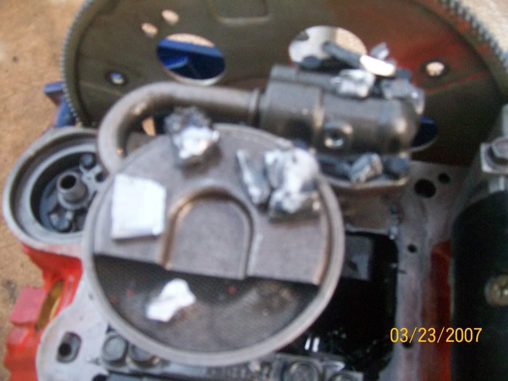

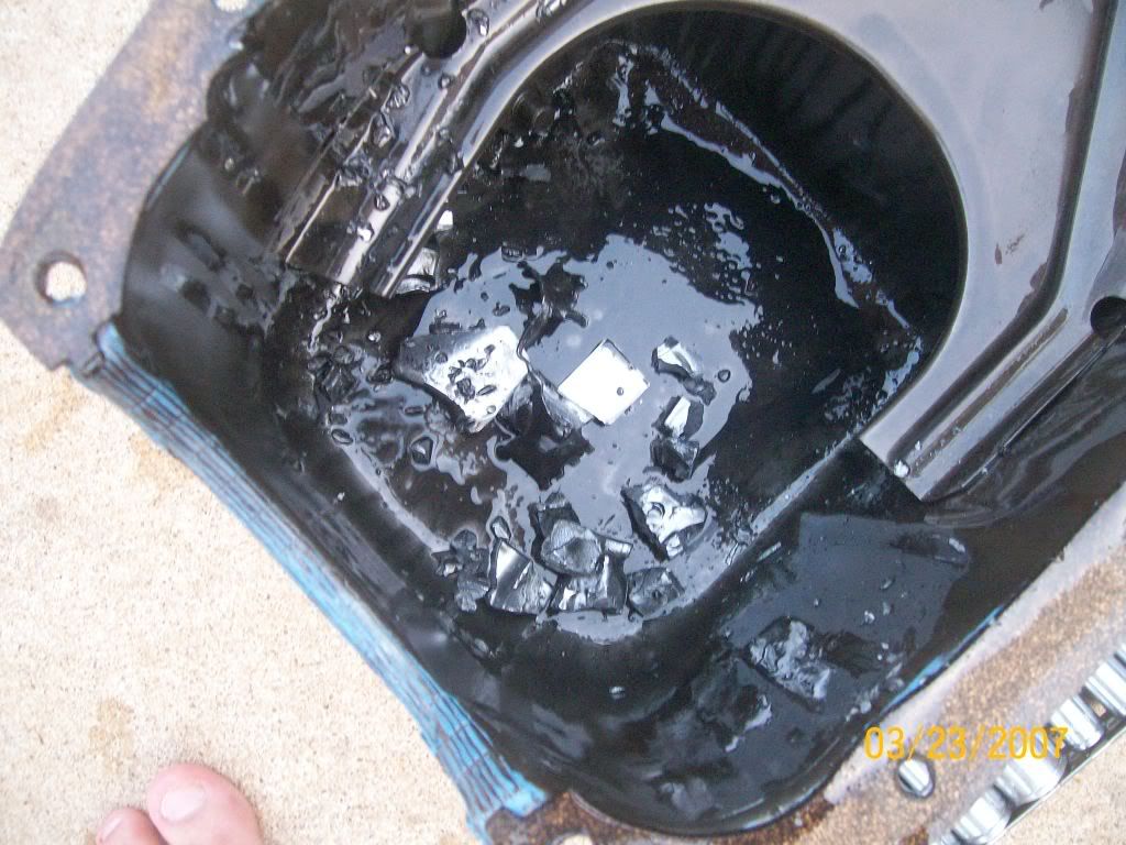

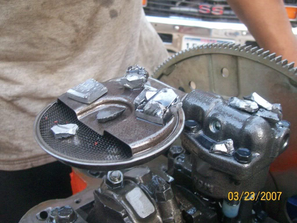

Hey everyone, just got back from vacation. I'm not all emo anymore and my heads up high. All i needed was a break from the nova. I was anxious to tear it apart. Got home today around 12 and i got right to work. Finished around 6ish. Anyways here are some pictures. Looks like i need some new pistons and lord knows what else. I just can not believe improper break in did this. Learned my lesson the hard way and learned it GOOD! :yes: but time to move on.

If you broke a piston that bad you may have broke the block when the loose rod punched the cylinder. If the engine's been over bored you won't have a lot of meat left to go bigger safely.

How in god's name would improper break in cause a piston to break like that?:confused:
you have to run bigger ring gaps than forged or cast pistons. If not....(insert noise for bomb exploding):devil:
I'm no expert, but... I'd think the worst thing that can happen with improper breakin (at least in the 20 minute timeframe you ran yours) is wiped cam lobes and toasting the rod/main bearings/journals from the resulting filings. What you've got there is piston chunks.
Ring gaps too tight? Valve hitting the piston? Valve lash too tight? I'd call the builder...

Nonsense, there's nothing wrong with hypereutectic pistons. They are quite strong, but don't "give" like a forging--if you detonate them they can shatter, but it takes some pretty serious rattling to hurt them. KB's do require larger gaps (or you end with broken parts) Some like Speed-Pro's can be installed with conventional gaps. One of my 391's with 13.5-1 KB's ran 10.20's--I used .039" gaps.
That doesn't look like it had anything to do with improper break-in. Was there any evidence of piston to valve contact? Are those KB pistons?? (on the bottom they will have KB or Silvolite cast in)

Just curious...but.....that almost looks like improper piston-to-bore clearance or a problem with the bore having too much taper or out of round. I'd bet those are most of the piston skirts.:yes:
Definitely nothing to do with the break-in process!!!!:no:

Ask them the hard questions before they start looking at anything. Bore clearance? Amount of allowable taper? Ring gap?
THEN get them to do some measuring right in front of you!! It's kinda hard to argue the numbers!!
What might get REAL interesting is if they claim not to have a dial bore gauge to accurately measure the bores.:rolleyes: Or if they refuse to do any measuring in FRONT of you and just want to take it in the back for their guy to "Check it out".:mad:
