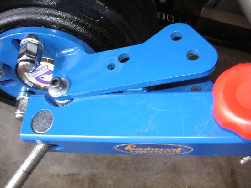

I found a guy renting the Eastwood fender roller on Craigslist. I picked it up, hoping to get some more clearance for the rear meats :eek: :
I bolted the bad boy up, torquing it to spec...
Then fiddled around with the adjustments... but to no avail. The roller's arm is too dang long, and on the shorter setting, you can't get the Delrin roller at the correct angle. You'd need to fab up something different to get it to work. And YES, this is with the rear at full drop!! Wrong:
Right (but no place to pin down the arm):
Just thought I'd let you know before you blow your hard earned money on renting (or buying) this tool for your 3rd gen. :(
Guess I gotta go with the old-school method of a dead blow hammer and a shot bag...

You can relocate the adjuster location making the arm shorter, you will have to expand the roller arm out at this location.

Pic is misleading. I had the jack/jackstand under the body, not the axle. And I removed the shocks, so everything was at full drop. No way to get it any lower other than removing the whole axle. :(
I tried this... no workie. :mad: Oh well. Just wanted people to know not to waste their time, because the tool is not designed to work with this type of "eyelid" type wheel well... only full radius round wheel wells.

I do guard rolling as part of my business, so I've done quite a few. Here are a couple of suggestions that have worked for me in the past.
Disconnect lower shock mount and temporarily bolt on a shackle plate from a leaf spring to lengthen shock travel. That normally gives enough length to get the tool under the guard.
My tool is drilled with a second set of holes(not an option on a rental) but some times this fouls a wheel stud that needs to be knocked out.
Either method gives good results. Rear guards with double thickness are hard work but can be done with effort, just let the tool do its job.
