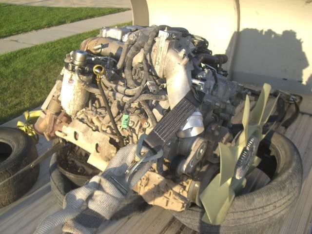

Duramax Diesel 66 wagon FINALLY DONE
Plans have changed so I just picked up 06 Duramx (code lbz) better rods,crank, and pistons. We will be running a built 4l80e behind it. Set up with have a custom intake and maybe twin turbos(we shall see) Worlds first nova with a duramax??? This will be the sleeper.
Nova wagon
meets duramax
Should be an insane setup. Gathering parts now will start build soon and add pics as we go. Plans are to have it running and on the road first of next year(uncharted territory) We will do the power tour with it as well.
