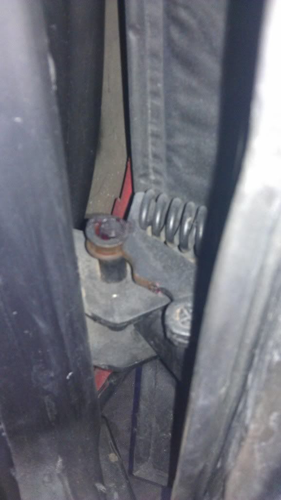

My doors on my nova hang its not because theyre installed wrong its the hinge pin bearing im guessing its called has no bearings im assuming. If I would to buy it from ebay How would I go about replacing them. Do I have to remove the door to get to the hinge and how would I go about the spring? Or is there an esier way without removing the doors that someone has figuered out?

Driver Door
Passenger Door

So looking at the pictures were do the bushings go? Looking at my pictures does any bushings go in the guide wheeel?
