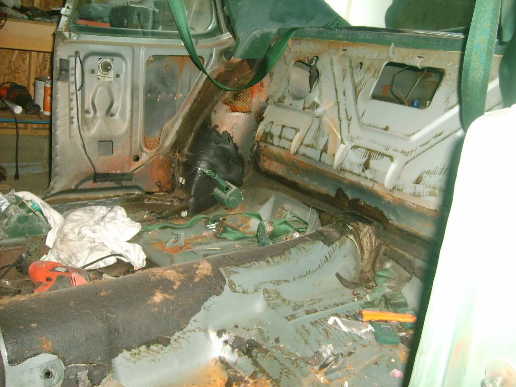

well i officially started on my car here are a few pics of what i have done so far phase one tare down
body work is my first priority then on to the mini tubs that i got from DSE:D

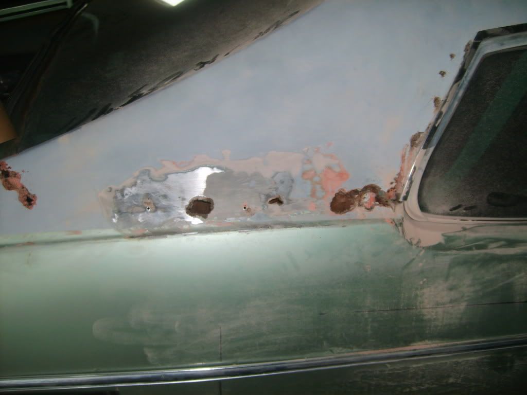

well after cutting out for the patch i noticed that someone had done a patch job on this car before.:mad:Or should i say hack job so now i think that im gonna replace both sides with full quarter skins on both sides since i think the other side is the same way:eek::mad:

does anyone know what guage metal to use on the rear wheel wells they have very small bad spots and i don't wont to spend the money on a whole new wheel well so any help would be aprciated.Anyways the project has been going slow but i have got some things done see for yourself:devil:

dont look to bad for a buckeye car......
I have seen far worse....
jus keep plugin away...

73-74 nova rear quarters
From what I have learned lately there are no complete rear quarters available with the sail panel for the 73-74 cars,to replace the quarters and keep your original body lines,the replacements produced are 68-72,they would have to be cut below the body line when replacing them.The body lines below the rear passenger windows is different on the 73-74 cars.
