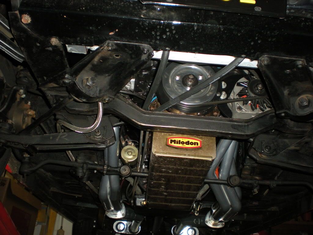

If you look at the area where your front subframe bolts to the body, there should be a hole already drilled in the flange between the two, kinda up high. I am pretty sure this is where the original line ran, along the edge of the frame, on top of the lip, and then made a left through the firewall. I don't have a picture of my wheel well, but here's a shot from the top. The hose coming throught the firewall is from the tank, and has a 90* -an fitting on it.

I took a quick peek under there and BAM!!! The boyz were awake:bounce::devil::bounce:. Man I messed around and got all excited when I saw the new package on the porch, it was my coil over kit:D it made it!! So during my short peek I did not see a clear path through the firewall for the fuel line. I like how you came through the fender well with yours and also the Positive battery cable. That’s just another thing on the list that will get change on this go around. The other two braided lines are your tranny cooler lines, right? Looks good, thx for the pics. If anyone has a pick of a clean fuel line for a mechanical pump please post as it will need to be routed during this procedure. Thx again!! Smitty
