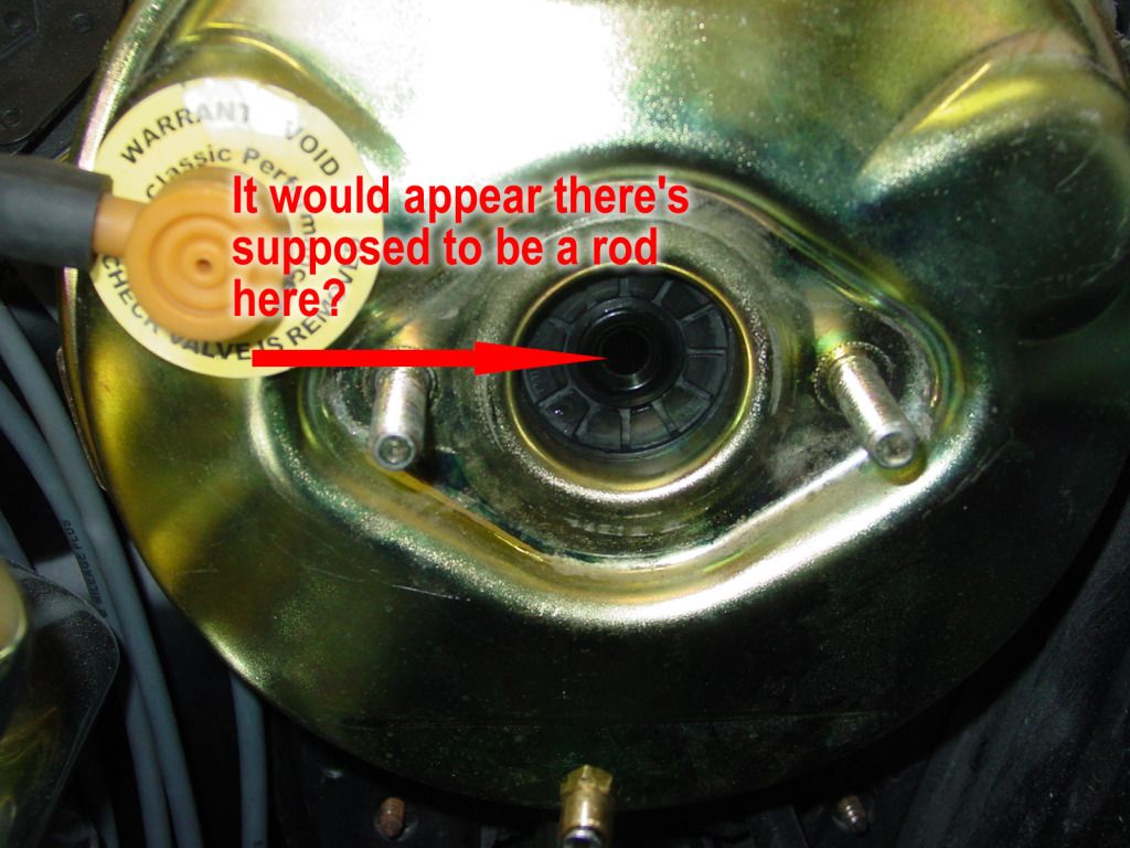

I bought a CPP Booster/Master/Proportioning valve combo from a member here. It was new but not in the original box. Now that I have it running the booster won't hold vacuum.
I can actuate the master with the plastic cylindrical tube the extends out when the pedal is pressed, however it would appear that there's supposed to be a rod between the master and the booster. If you look down the hole in the booster there is a recessed hole that apparently a rod fits into. Could that be the culprit?

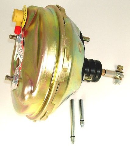

I found a picture on another site of the same booster and it definitely has a rod, but the guy at CPP didn't know if there was a rod or not. He would have gladly sold me another booster for $189 though. :mad:

You're right, there's supposed to be a pushrod in that hole. And that's definitely the source of your vacuum leak.

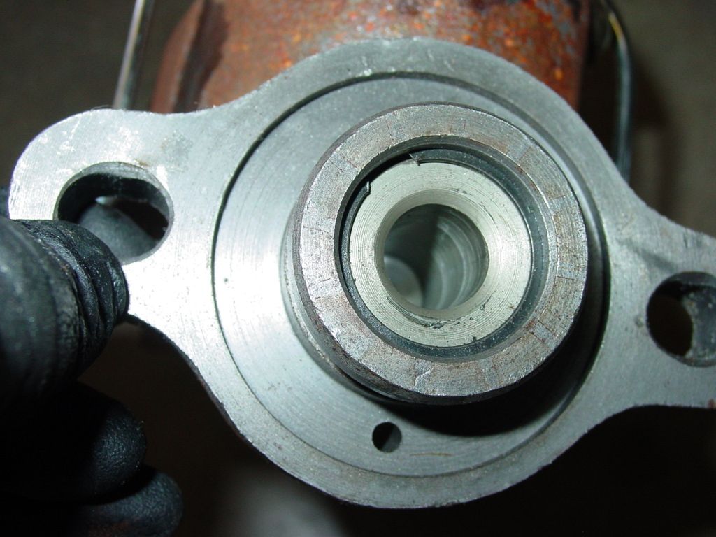

Here's a picture of the piston end.
You also need that clear plastic piece that holds the rod in place. That piece is the seal between the m/c and the booster. RICK
Chevy2Only lists a booster and it has two rods that come with it. From the picture it looks like a CPP? Kinda answers my question. If I can get the part number hopefully I can get what I need from CPP.
http://www.parts123.com/parts123/yb...S3K70L6FNV63231214203a~Z5Z5Z5~Z5Z5Z50000132A#
I downloaded the catalog today and sure enough they show the parts. I do think I need the long one. Part # 6474SRB-DP for $2.00. Their website leaves a little to be desired and I wasn't even aware there was a downloadable catalog. I wonder why the guy at CPP couldn't have done that? I've spent two hours on something that would have taken the guy 60 seconds. Oh well, I've wasted time on more trivial things I guess.

Normally that booster would come with a short rod, and there would be a bullet in the back of the master cylinder to make it work with a short rod. You should be able to get the long rod to work, but be sure to double check the length of the rod and the recess in the master cylinder. Needs to be close, but not keep the spool valve of the master from returning completely.
