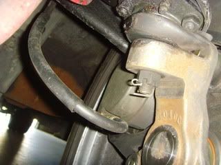

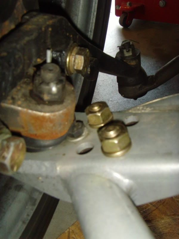

Here are a couple of pictures of what I am dealing with. The lower balljoint dust cap is being pinched between the 2" drop spindle and CPP mini subframe kit lower control arm. This is when the car is jacked up off the ground. Both boots have multiple holes in them and I have 600-700 miles on everything.
Is this normal? also the upper boot is toast on the drivers side. I almost think these spindles are for a 68-74 Nova, but any input would be helpful. I was told today this is normal by someone at CPP.

Well it is a problem.I put Button Head Allens in mine and ground the spindle to make clearance.
3,855 Posts
Normal? I hope not. Just from the pics it looks like the boot is being pinched because the CA plate is too close the the ball joint housing. Looks like a bolt head is contacting it too.
Your pic, was that at ride height?? Or full droop? If its at ride height what is the angle of the lower control arm? That ball joint is angled in alot for ride height, not bad at full droop though. Pics may distort it though. JR

The picture was taken with it on a jack and wheel off the car. Ok, another question is what happened with this kit from when NOGO did the write up, to me installing mine?
NOGO's installed picture-look at the huge amount of space compared to mine
I undersand he has stock spindles, but it looks like the lower balljoint is at least a 1/2" shorter on mine.
The boot is being pinched between the two. Every time I jack the car up another hole is formed.

My spindle looks like it's seated too far into the lower balljoint. I thought on our cars they sat up higher, as compared to the 68-74 cars?
Even with added material on NOGO's spindle it still would clear the control arm under full droop.

Here is the way mine was before.It is really only an issue with the front wheels are off the ground.With the car on the ground the bind does not exist.Here the spindle is bound up on the ball joint bolt head
Here is after clearancing and installing Button head allen bolts.All of the pictures are with the front wheels off the ground with the suspension at full droop.
It is not a safety issue just a marginal design flaw.I suppose the joints would wear out quicker once the boots are torn open and will not hold grease.Need to keep an eye on that.
