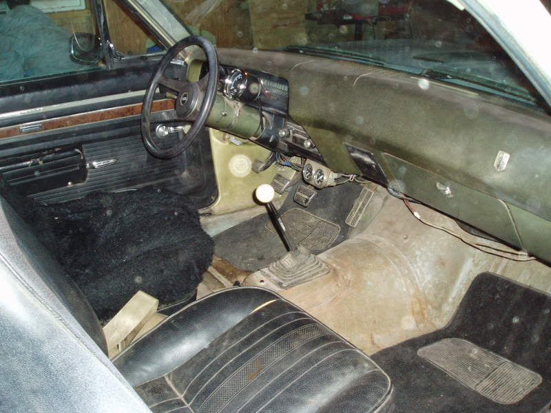

Yeah, that is what I am trying to confirm. I didn't think anything of the hump until I was browsing around in a catalog looking at interior stuff and noticed that not all cars got the hump.

See if you have 2 holes about 6-8" in front of the hump that may have held the front bracket for the console in place.
I don't ever remember seeing a finished carpet with the hump, like trim piece or something. I would say it's a console car.:yes:
1,093 Posts
Look at the heater box under the dash, console cars had an extra piece that redirected the air flow so that prevented the air from discharging into the leading edge of the console.
952 Posts
Wow I have never seen another 68 nova with 745 interior besides mine. This is a picture of my heater duct, which is a console car with the gauge package. What is your original exterior color gold or sequioa green? Hope this picture helps.
