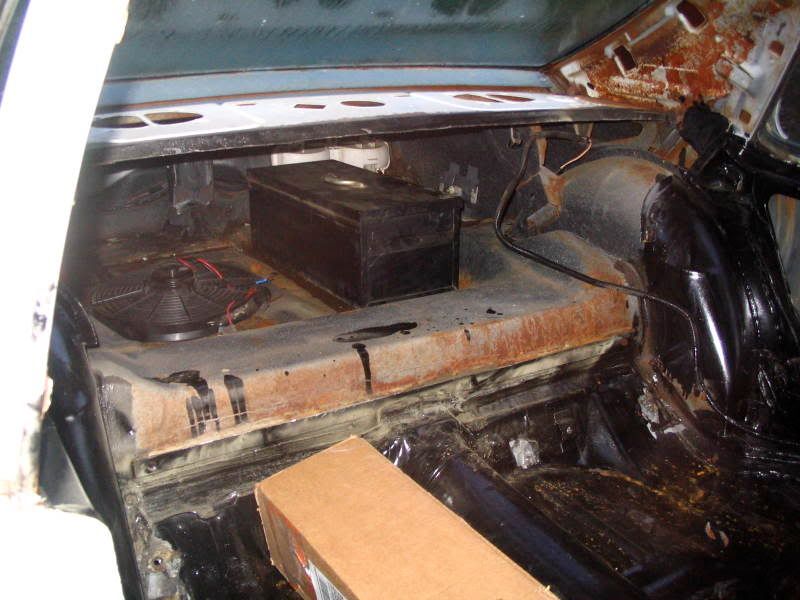

fitting the fuel cell and builing brakets

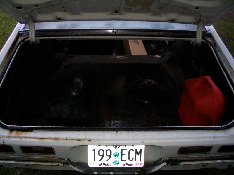

i cut all the brackets off this last weekend and tried to drop it off and i was told to do the back brace first so if it warps he can fix it in the jig. i also cut the other sheet metal for the trunk. I am lacking the one piece that goes behind the fuel cell. i have to make it so it can be removed easy so i can get the fuel cell out if needed. i am gonna take pictures tom. i am also gonna shave the rear marker lights, cut and weld the piece that the aluminum rivets too on the quarter panels, fix a small rust spot in the quarter panel, and disassemble all the aluminum so i can start cleaning up the trunk for paint. then hope saturday it will be nice out so i can paint the trunk and start putting it back together.

here are a couple pics. i made a template for the back brace. i will get it cut and on soon. i got the aluminum all cut and in place. i also shaved the marker lights in the rear and got the aluminum all in for good. i will take some pics this weekend.i am gonna do a lot of work finishing up the roll cage and floor of the car this weekend i hope and i will post some pics on next monday

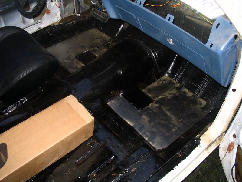

here are a couple new progress pics. i got the floor all in and used bed liner paint so it has a texture on the floor and sides. i also put in a battery mount this morning. i used 1 3/4 tubing to go through the floor to the frame. I have to do some final painting on stuff and polish the fuel cell back up after all my fab work is done.
you will notice i still havent bent the rear piece of aluminum that goes behind fuel cell at rear of car. i will do it today
i welded in the door bars, and attached the seat to cage
