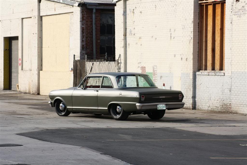

I LOVE that look:cool:!! Thank you for getting a 'side shot' for me. I am pretty sure of the look I want to pursue when the time comes...:yes:

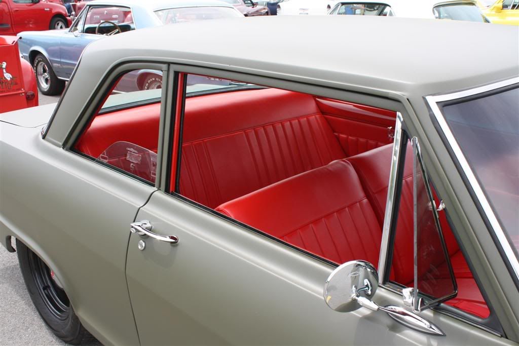

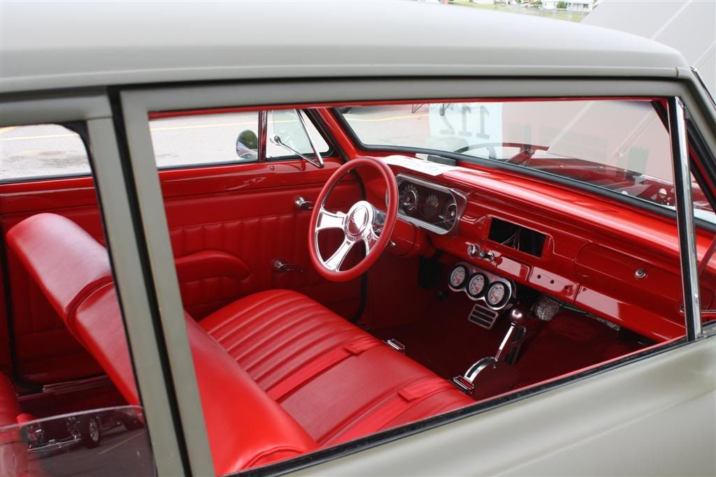

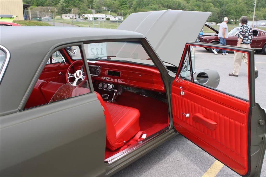

MPLS66 - I will get some interior pics up later this week...nothing to exciting, but it is bright!!
