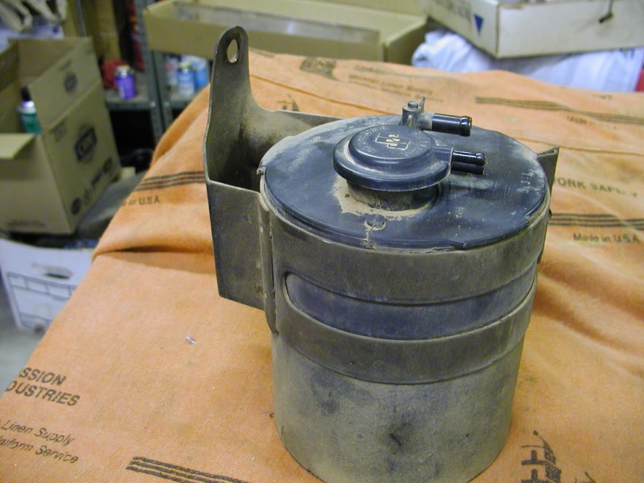

You know that black round thing in the front corner that everyone seems to think is not needed and toss it. Well if you park in an enclosed garage it will keep the gasoline fumes from causing a possible disaster. It takes no power to operate so why remove it.
Mine was looking really crusty so I thought it wouldn't hurt to try and clean it up a little.

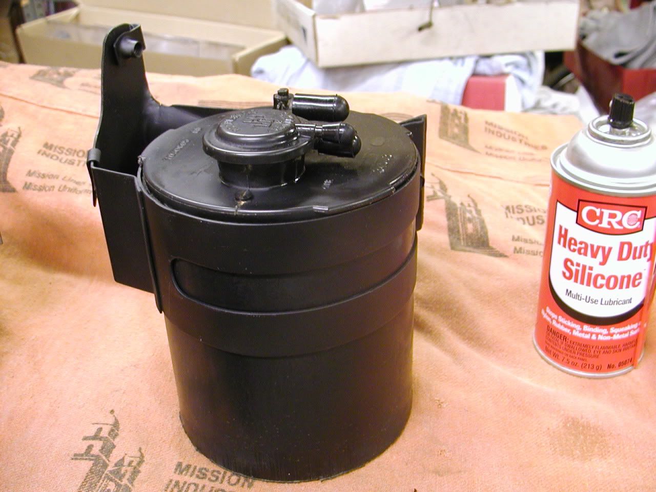

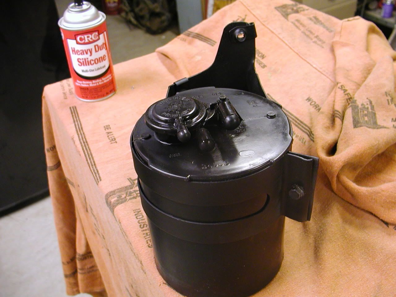

After bead blasting, priming and painting the mounting bracket I tackled cleaning the canister. Using just soapy water left from washing the car all the dirt and crud were removed. Clean but now kind of dull looking. I didn't want to paint it and while looking around the shop for some kind of wax or polish I noticed a can of silicon spray. I tried a small spot and it looked good so the whole thing was sprayed and then wiped.
Now it looks good enough to install into the car.
The silicon also will work well to make the fan shroud look new. I tried a small spot and soon will clean and treat the whole thing.
