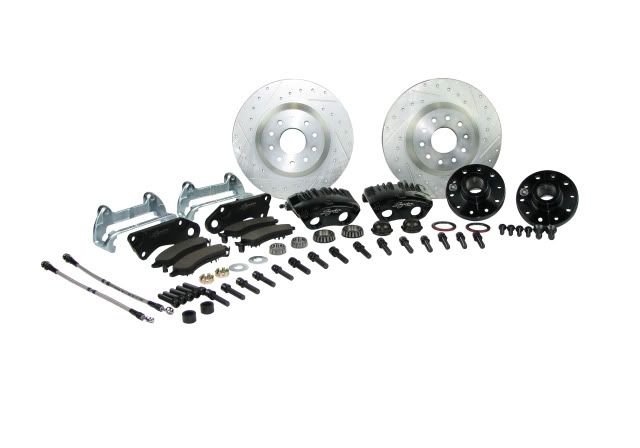

You wouldn't by chance have a picture or two would you?

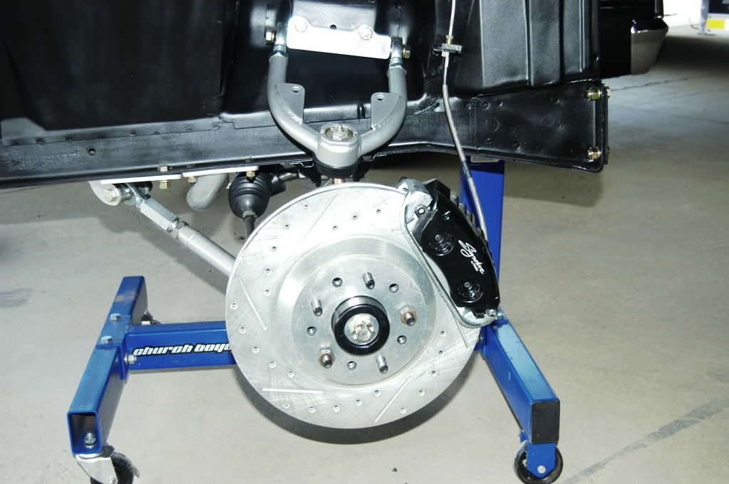

Are the calipers powder coated? any other pics (closeups/installed)?
Yes they are and here is a picture
What is the offset for the front?
I am not certian but it looks like it should be similar to the LS brakes which fall in at 1/8ish over drum and about around 1/2 less than a Chevelle type brake.
