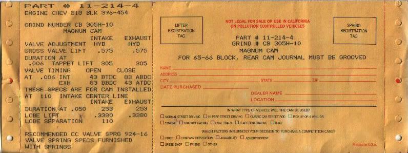

I have a 850 cfm vacuum secondary and want to go with a 750 mechanical do to the 4 spd and the cam doesn't like the the vacuum carb. So my question is, what do I need to do to make my 750 cfm work with this set up? I'm not overly familiar with tuning Holley's.
Here's the cam specs

That looks like a pretty healthy cam for just 9.5 comp. in a 396. I think the cam isn't liking the compression more than the carb.

That cam isn't ging to produce any stella off idle performance in your engine. It would be much better at more like 11:1 compression. You're probably not putting good power out untill 3500rpm or so. I ran that cam in a 400cid engine at 10.75 compression with a 3.70 rear end. It really liked the 4.56's when I swapped them. It was just more of a high rpm engine. I think a 750 will give you a little throttle response back, but I think you just need more tuning with the carb you have now. If you go with a new 750, I'd suggest one with the Proform main body, or a HP so you can tune the carb with the air bleeds as well. Something like this:

That cam isn't going to have the greatest low speed manners i'd say no matter what carb is on there. Ya gotta remember a hydraulic cam acts like a solid with anywhere from 8 degrees to 12 more duration at .050. Your cam is pushing the " street " in street/strip to the edge of the envelope while your compression is not near the edge.
I think i'd look at this cam ,
