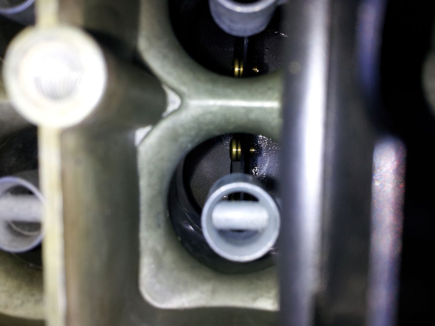

Here are a couple pictures I just took. Dont know if they will help at all.
3
Have you tried leaning out the choke deal (black part, says Holley) I see you have it set I'm the middle. Aren't they usually a click or two to the lean side? I'm just guessing
Sounds like a blocked air passage. Get some carb spay and reclean and blow all the pasages again. Or wrong metering block gaskets. RICK
Did it back fire thou carb by chance?.3310-4 do not have PV blow out protection,Turn your mixture screws all the way in when it is running, does it die or smooth out?
