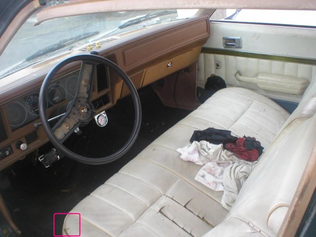

looking at your gear selector, it appears to be for an automatic, i believe i can see the "PRND21" options in your dash board.
