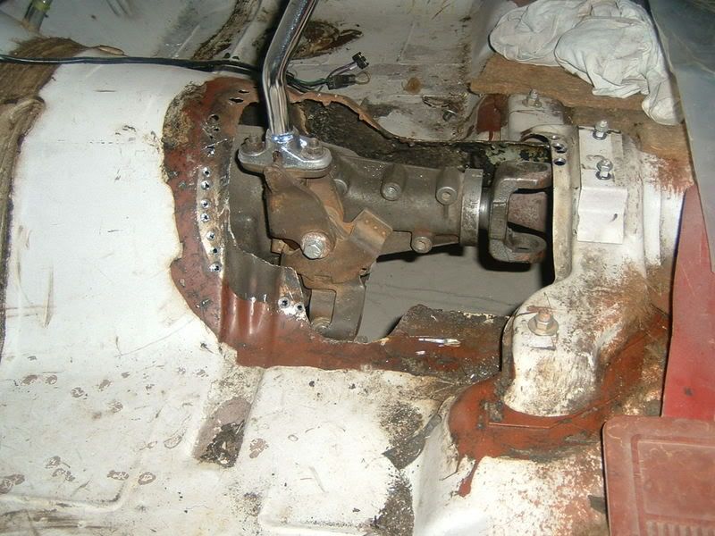

A few years ago, I removed the auto hump from my 65 to convert to 4 speed. Here is a picture I took with the hump removed. I have already cut enough to make the 4 speed fit, but it appears at the back the cut is still original. You can see I had to drill spot welds our of the floor support, indicating the hump likely went underneath the brace. See the 3 holes on top where I drilled?
It seems to me I recall having to fill in quite a bit of hole in the top of the tunnel underneath the brace when I removed the auto hump.

Interesting. I didn't think it might have supposed to fit under the braces.

The factory floor pan at the transmission tunnel in a '65 Nova SS is larger (wider/taller/bigger around) than the transmission tunnel in a '65 non-SS car. I found this out while working on my '65 SS along side a friend who was working on his '65 non-SS HT. Both of us had our interiors out and were able to make a direct comparison.
I can't speak to the other years, but I would guess the hump sold by places like Classic Industries is fashioned after the hump from the original SS cars with the larger tunnel, and therefore may not fit a smaller, non-SS tunnel as well without modification.
