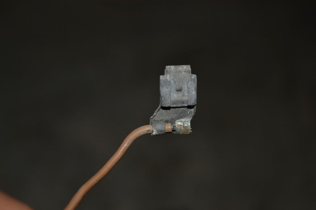

I'm looking to add headlight relays to my 2nd gen, and I want to wire up new 12ga wires from the relay right into the headlight without using ANY of my old, crusty, thin wire. So I'm wondering if anyone knows where to get the actual copper/brass terminal that snaps into the plastic headlight connector. Here's a pic of the piece I'm talking about:

Badboy, here is what I do when replacing headlight terminals/connectors on 1st and 2nd gens. I drill a 1" or so hole in the mudbucket - directly behind the headlight connector and then install proper size grommet. Run the headlight wiring thru the grommet/hole to the connector and use these connectors and terminals.
http://shop.americanautowire.com/search.aspx?find=500196
OEM connectors/terminals are 90 degree version designed to fit between the headling bulb and the mudbucket. AAW version needs the drilled hole for clearance.

Do a search for Packard 59 terminals. Widely available. You can get them in any gauge you want. You should also use the proper crimper. I used straight connectors and plug. It worked fine for me.
These are the guys I bought from. www.pcsconnectors.com
