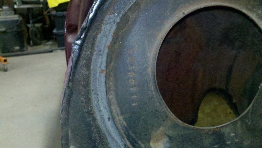

In a similar vein, has anyone else seen the serial number (VIN) stamped vertically outboard of the hole in the firewall for the heater motor?
I'll get picture and post it later.
Here is is.
