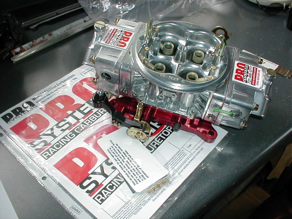

I was going to buy one but then I found out about Pro Systems carbs. Custom built carbs, built to your engine's specs, bolt it on and pretty much go. A little more than $700 dollars to your door and no messing with it. Comes with full 7 day a week tech support.

I had a Pro Systems carb on my 355. That is what I have now on the 406 (for now).
I won't say I wasn't happy with it on the 355...just thought I'd pick up a few more et wise then I did.
It does run good at cruze and wot. Idle was a little rich tho even with 21degr initial.
I guess the carb it replaced (750 proform main body) was pretty close to begin with.

One thing I couldn't understand was the holes in the thottle plates for my 355 with a 227/232 HR cam. It made 14in of vacuum. I wouldn't think it would need it.

Yes I'm the original owner of the carb and I did call about a hesitation I had with it.
I didn't expect a second differance between the two carbs...maybe a couple 10th's tho would have been good.
Like I said it's possible that I just had it dialed as good as that old combo could get with the old carb with the old seat of the pants dyno n vacant road. :D
I even e mailed him about using the carb on my new 406 and he said to sell it to offset the cost of the new carb and I would need at least a 840cfm with a small venturi/large throttle blade as the 780 will really slow the car down with the smaller throttle blades act as a restrictor plate on our program .
