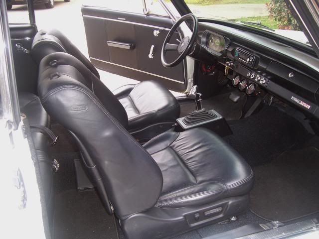

I had them shipped to the closest freight terminal and picked them up there because home delivery was another $100 extra.The inside front floor boards next to the tunnel had to be flattened and the floor area between the front and back mounting points along by the tunnel had to be massaged with a hammer to get the seats to sit level .The front and rear stock seat mounts in the floor board for the front stock bucket seats had to be removed to get the the new buckets to be level.
The existing mounts on the new seats can be bent or unbolted and mover around to make them work.

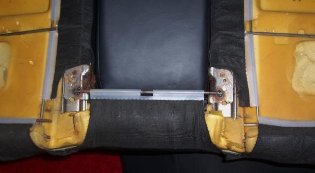

I have a copy of the wiring diaghram and they move up and back and up and down as well as recline, they have heat too if you want to hook it up..The top of the back seat will fit if you open up the hooks below the package tray a little and they have a bracket at each lower corner that can be used to secure them with a bolt that passes thru the floor pan.
The center of the upper cushion has to be notched a small bit to clear the tunnel.

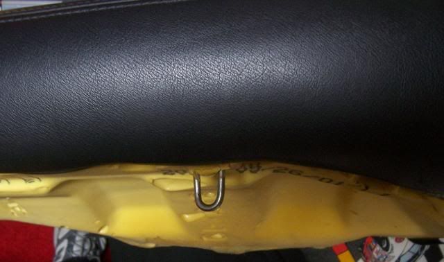

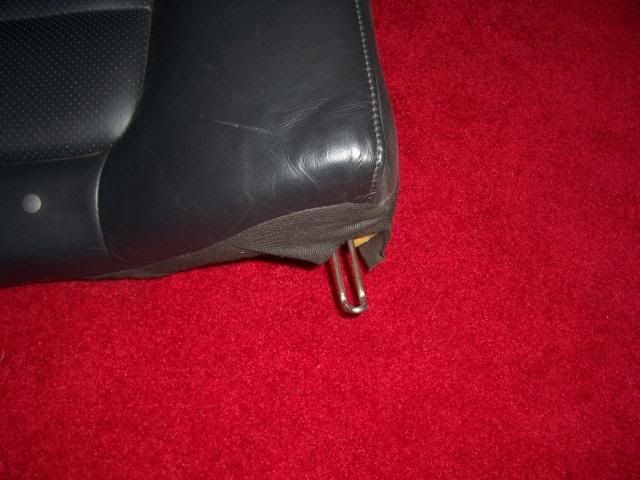

.The bottom cushions have two wire loops on the front at the bottom.I but two bolts up thru the floor right in line with each of them on the floor just past the kick up from the rear foot wells.I made a piece that slipped over the bolt and then as it went towards the loops in the seat I bent it down 90' and drilled a hole and spot welded a nut behind it.Then got a bolt that was long enough to reach and it helps pull that cushion back to look right.The gap between the seat hooks and the bracket needs to be large enough to let the cushion go back far enough to look good.

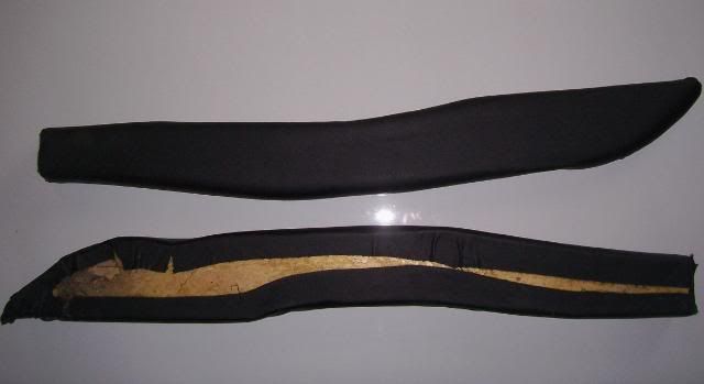

I took a 2x4 and put it between the upper seat custion and the side of the interior.I marked the conture of the seat on it then cut it to fit the shape of the upper cushion.I cut a little of the width out of it and then covered it with a little foam and black material to match then the fit was tight enough to hold it in place.

Excellent job! Looks like you had a little work getting your late model seats in too. Seats look good. My Concorde back seat attaches in just about the same fashion as yours does. My bottom rear cushion also had the two wire loops in the front. I see you made a bracket to attach them to and pull them into place. This is where I built an extension "shelf" out of wood instead to pull back mine into position and to give it more support in the front.

That looks great !!! :thumbsup: Nice photos too, thanks.

those seats look amazing! i think some people tend to put seats in that just dont look anything remotely close to "date" correct but those seats look pretty good to me. i have the same front seats out of 89 or 98 acura integra - i didnt get the headrests with mine. im thinking of recovering them in vinyl and using them. I am glad to hear those seat brackets work w/o much fabrication.
thanks for posting the pics.

I would say that the TL seats were about 4ins. more narrower than the stock rear seat.I made the filler out of 2x4s that were narrowed a little then covered to match.I didn't worry about the lower cushion because it's gap wasn't noticeable.
