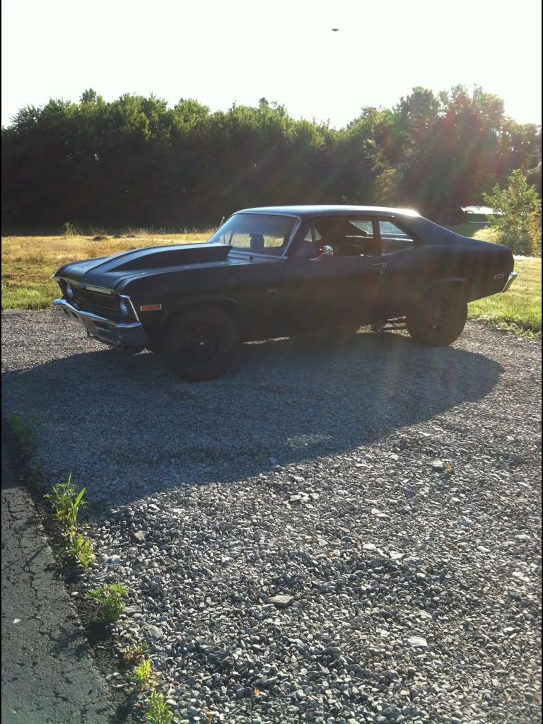

I recently decided my 1969 project car wasn't worth the money I knew I would have in one when I got it to where I wanted it to be a million years into the future. So it's about to hit the market ASAP. In the mean time I picked up this beauty from 1quik70 (forum member) in Indiana. In my 600 mile journey from Arkansas to Indiana to buy it I stopped to spend a little time with a friend in Nashville who was getting deployed to Afghanistan the following Tuesday. We went to a bar where the girls danced on the bar like a Coyote Ugly type deal. We told one girl Chase's story about being deployed and she basically accosted him in front of the whole bar hahaha! She was always shoving cards in our pocket for free admission to a 'house of I'll repute'...to say the least. The name on the cards was 'Jocelyn'...due to the fact of what kind of cards the name was on and the fact I look at the car as a kind of dark, sultry kind of sexy...that is now the Novas name!
Car facts:
1970 Nova
Quarter have been replaced
PPG Hot Rod Black Paint
New bumpers, grille, trim, bezels, lenses
New 3/8" fuel lines from tank
New brake lines, prop block, master cylinder, line lock, and booster
New front drilled and slotted rotors and calipers
New ball joints, control arm bushings etc.
3 way adjustable shocks on all 4 corners
4" fiberglass cowl hood (full lift off) on custom rails
396 bored 0.030 over
580 solid lift cam
750 CFM Holley Carb
Holley Black electric fuel pump
31x19 aluminum radiator
Dual electric fans
MSD pro billet
MSD 6AL
TH350 w/ 3500 stall
Derale remote trans cooler with fan
Pistol grip quarter stick
8.5" 10 bolt w/ 411s
Moser Axles
Carrier Girdle
Cal-Tracs bars
New door panels (not installed yet)
Restored factory gauge cluster
5" Autometer tach w/ shift light
Autometer water and oil gauges
I haven't changed much so far but I will post the small things on a reply. Now is the challenging part...figuring out how to post pictures using an iPad.
