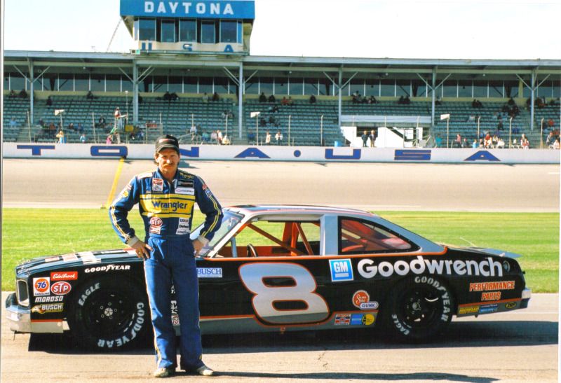

Heres another pic of dale in the early 80's next to his 78 nova
figuring they ran, what, a 12" tire front & rear... you'd be radiusing both front & rear wheel openings to accommodate that fat ol'tire...

Definitely opening up the front and rear wheel wells, compare the stock nova to this one and look from the top of the front fender to the top of the wheel well, looks like over 6" difference in my opinion.
Believe it or not but when they list that car they list it as a 89, They ran them in the late 80s with guys like Dale And Davey Allison and Larry Pearson, I have that Diecast in 1/64th scale, I bought the 1/24th scale off QVC the friday night before Dales wreck and death, I miss him like a family member I sold the 1/24th scale cause it hurt to see it, I felt as if I lost my best friend, Racing hasn't been the same since

I have both of the 1/24th die casts that were made of these Busch cars, one is Dale Earnhardt's and the other is Davey Allison. Typically, these higher end 1/24ths are pretty accurate and true to the original cars.
If you accept that premise, then yes they were full framed cars, built on whatever was the standard Busch chassis at the time, which is a full framed square tube box frame, with truck arm rear suspension, panhard bar, coilovers up front, the single side exit exhaust, and of course the cage and other race-car-only stuff. It also sports a Ford 9" rear.
Bascially, these were standard stock car chassis that the Nova sheetmetal was hung onto, that's part of the reason that they sat so low is because the chassis itself was designed to sit low.
Can it be duplicated? Sure, just depends on how far into the weeds you would want to go and how much you want to spend. There are all kinds of shops still fabricating stock car chassis all the time that could probably work with the Nova wheelbase and make it happen. I can speak from personal experience that the truck arm rear suspension setup really works well with these cars. Not sure where you are going to score an 850hp 358, but with unlimited funds I'm sure anything is possible.
From a financial standpoint, though, you probably just want to imitate the look without going the full-blown racecar route. That should be easy enough. Gut the interior down to the bare bones, Drop the front suspension about 4 inches, the rear about 6. Add some period correct NASCAR wheels and tires and you'd be pretty close, especially with a paint job imitating one of the original Busch cars. If you want to get really fancy, you could add a bolt in cage and there are several shops that carry the parts and pieces to build a single side exit exhaust just like what the Cup cars of today use.
