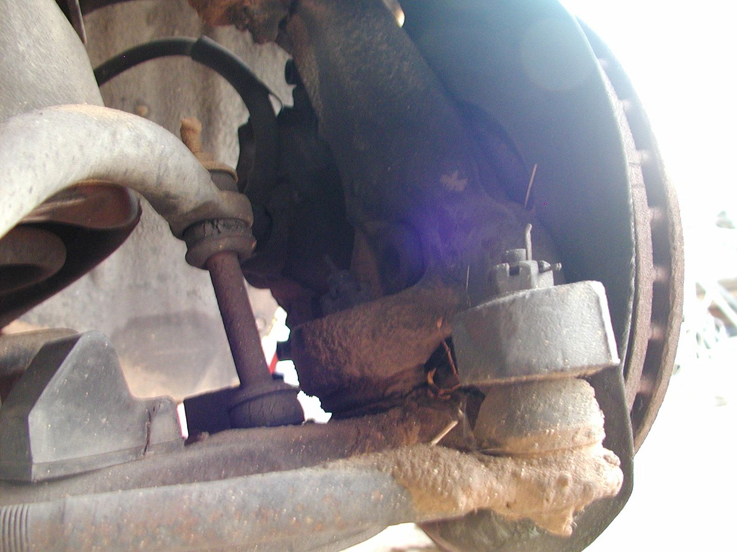

Im putting new ones my bushings and threads on other fell out so wondering if anyone knows in which way these may go in. Threads pointing up and washer then bushing and stuff thanks.

Stock assembly
Aftermarket assembly
Stock assembly
Phillip what aftermarket assembly is that? that may be what I am looking for!
BMR bar and arms, QA1 coil overs and shocks.
Ok and i tighten it up till it doesnt tighten anymore??
Sent from my PG06100 using AutoGuide.Com Free App
Tighten the bolt until the rubber bushings expand to the size of the metal washers. If using polyurethane just tighten them until snug.
Got it thanks
