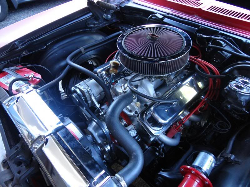

It was originally meant to be a budget vortec build, but with the added max lift and weight difference, the choice was made to go aluminum heads. I decided to go around this engine based on this article by Super Chevy: http://www.superchevy.com/technical/engines_drivetrain/cams_heads_valvetrain/sucp_0604_chevy_engine_performance/ The dyno for the 307 in the article uses a smaller carb, intake manifold and cam than I did, and it produced over 300hp. Mine sounds mean, and gets on it nicely. I would assume mine is at least a mid-300 horsepower engine. Here's the details on it:
Stock 4 bolt main 350 Short Block (Everything was blown apart, cleaned and checked good. Block was tanked and honed)
Comp Cams Xtreme Energy Hydraulic Flat Tappet 274/286, .487/.490 Cam and Lifters
Comp Cams Magnum 1.52 Roller Tip Rockers and Pushrods
Edelbrock E-tec 64cc/170cc Assembled Aluminum Heads (Edelbrock says compression is 9.5:1 with stock pistons)
ARP Head Bolts
Edelbrock RPM Air Gap Vortec Intake Manifold
Edelbrock 750 Electric choke Carburetor
I've seen a lot of articles and questions about budget vortec builds, so I just decided to give it a try. In my opinion, it's great! Rough estimate on total cost is around $2,000.
