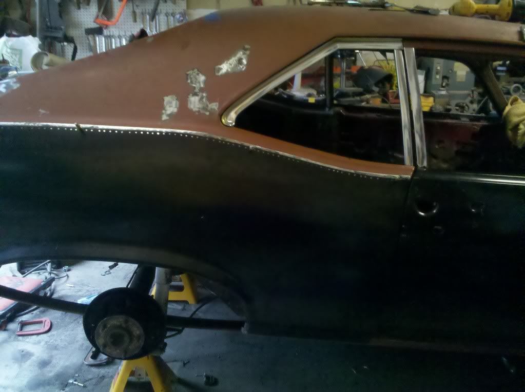

You don't need the machine, but it's nice. The alternative is a series of holes, cleco size, about 3/16" drilled or punched in the fender skin. Harbor Freight has a flanging/punch that does a great job at a reasonable price, but you may be able to rent one - maybe even better. Install the holes about 1" apart, clamp and start skip welding filling each hole as you go along. This also works for welding the other seams on the panel.

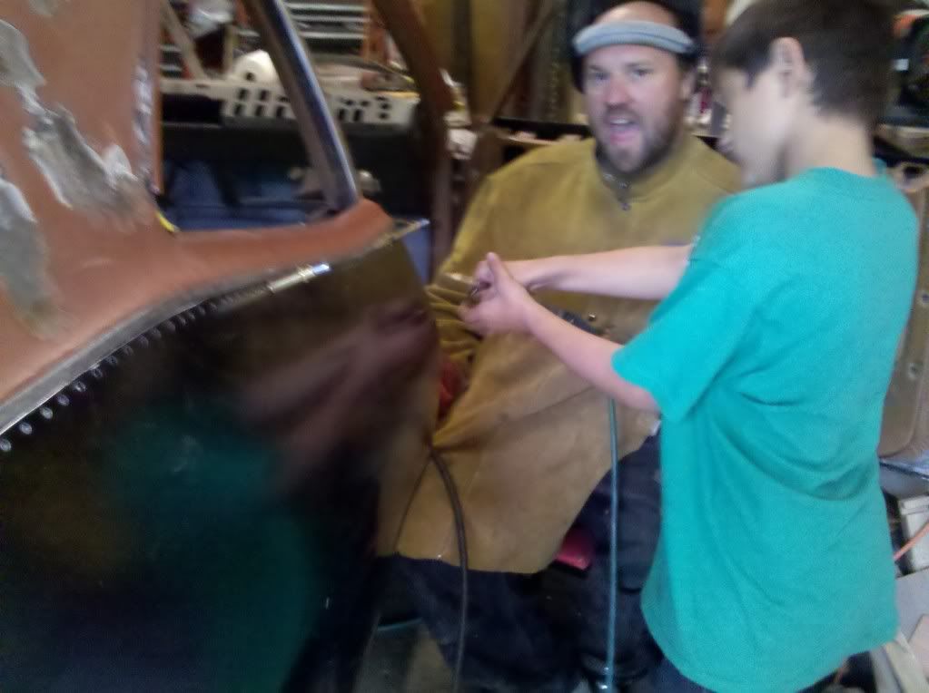

Keep the metal cool by blowing cold air on the welds. You should be able to put an ungloved hand on the surface and it not be as hot as a cup of coffee. That's my son putting his son to work.

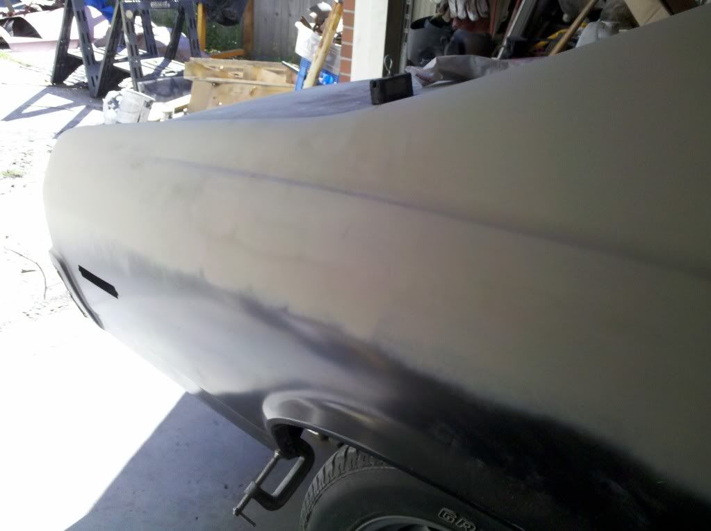

Primer & high build

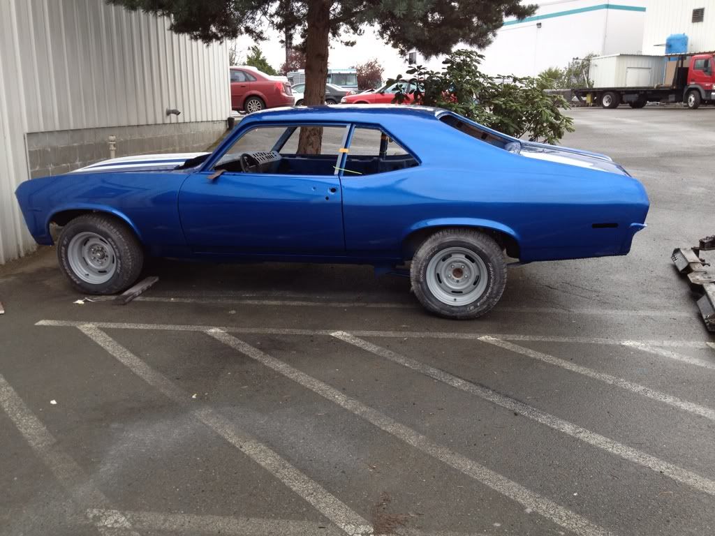

painted - both sides were done the same way

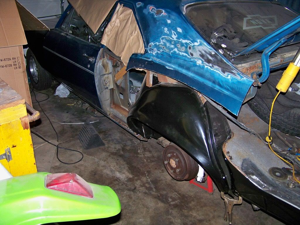

the wheel lips get holes punched about every two to two and half inches apart and then plug welded to the outer wheel house when your done you grind the plug welds down flush I don't have any pics on photobucket showing this but here is a pic showing me fitting new outer wheel house before I put the new qtr. panel on if you look closely at the rear of the lip of the second picture you can see where the welds were ground flush
PCPETE, did you flange the original quarter and then put the skin over it?? That came out clean, I just finished mine, but butt welded the panel in.

Yes, we flanged wherever we could. The same tool for punching the holes has the flanging dies.
