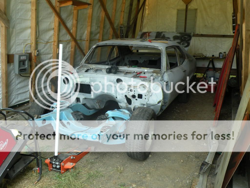

Well i guess its time to show the site my Nova. Its a 69 3 on the tree straight 6. I am going to SS clone it and put a 396 with a 4 speed. The trans i have know is a Saginaw 4 speed side loader, i think i'll stick with it. I also have a 10 bolt rear and was thinking of trying one of those lock right positive locking differentals in it. Do you guys think the 10 bolt will be strong enough?

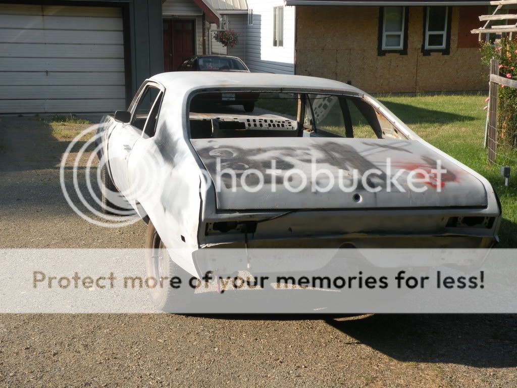

Im still looking for a stance i like, im thinking lowered enough just to hide the tires a little more than the stock high. Probably will run either rallys or cregar's. By the way whats the biggest tire i can run in the back without any mods?
Here she is
My Workshop
A little bit cleaner now
Getting a start on things
Coments and Tips most appreciated

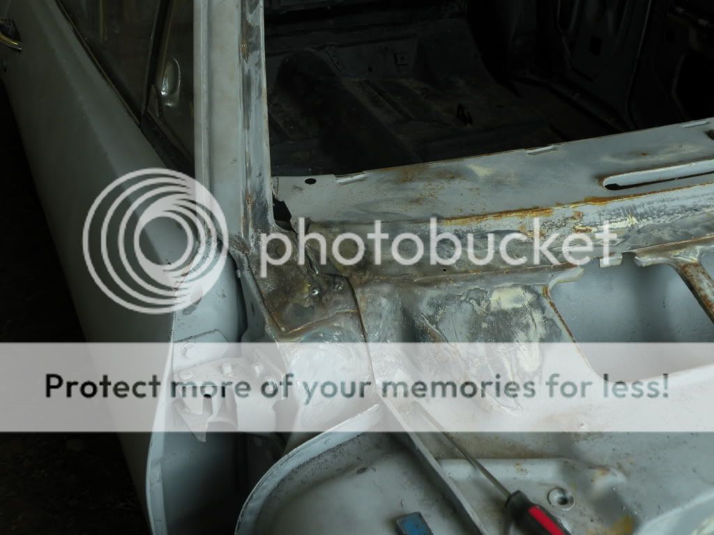

How would i go about doing this area?
New Floor and trunk pans
New Quarters, still have to instal the tail panel
And of cource the whats left or the rust
Should i replace this panel or patch it up?
Also how would i go about doing this area?
Thanks

Buy a 110 welder for a hundred bucks at Harbor Freight. Some of those holes were small enough you could fill in with weld.

HHmmmm looks like a fun start... IM wondering why your rear tires are not centered in the opening....... Are the springs installed correctly?
371 Posts
Discussion Starter #7
The rear end wasent bolted in proporly, it was just loose
Then would i grind it smooth? I dont think i can get close enough without damaging the trim clip thing.

There use to be some special popreivets that you could put in the place of the removed pins but I can't remember who makes them. Search around on google, on mine I used sheet metal from an old hood and patched the rear window channel.
Did you just patch around those pins?
1,342 Posts
most of that stuff you can do yourself with a welder and some good body hammers.
dont do full welds when welding on your car! do spot welds all the way across! once its all tacked in you can do 3-4 tack welds on one spot and then move somewhere else. keep alternating between places till its all connected. then grind it down.
cut out that piece with the pin on it and grind off all the bad stuff so you just have that pin left. then weld it on the new panel. simple enough. i would drill through the panel and then weld it on from the back side so its cleaner.
and with rust that bad dont just try to weld it up! your going to be wasting your time. it will just keep burning through. REPLACE IT!
I was definatly going to do a full patch and not just welding it up.
I thought of welding it from behind, but i was told that the new clips are just a screw on anyways. their would be no point in welding those pins back if i wouldnt be using them.

the largest tire under mind is a 275 50 15. if i wanted to role to quarter lips i could maybe fit 295 under it but its not worth that extra bit. this is all done by a 15-7 wheel with 4.25 backspacing the 295 would take a 4.50 backspacing. its not how wide its the tops of the tires hitting the top of the wheel house.
