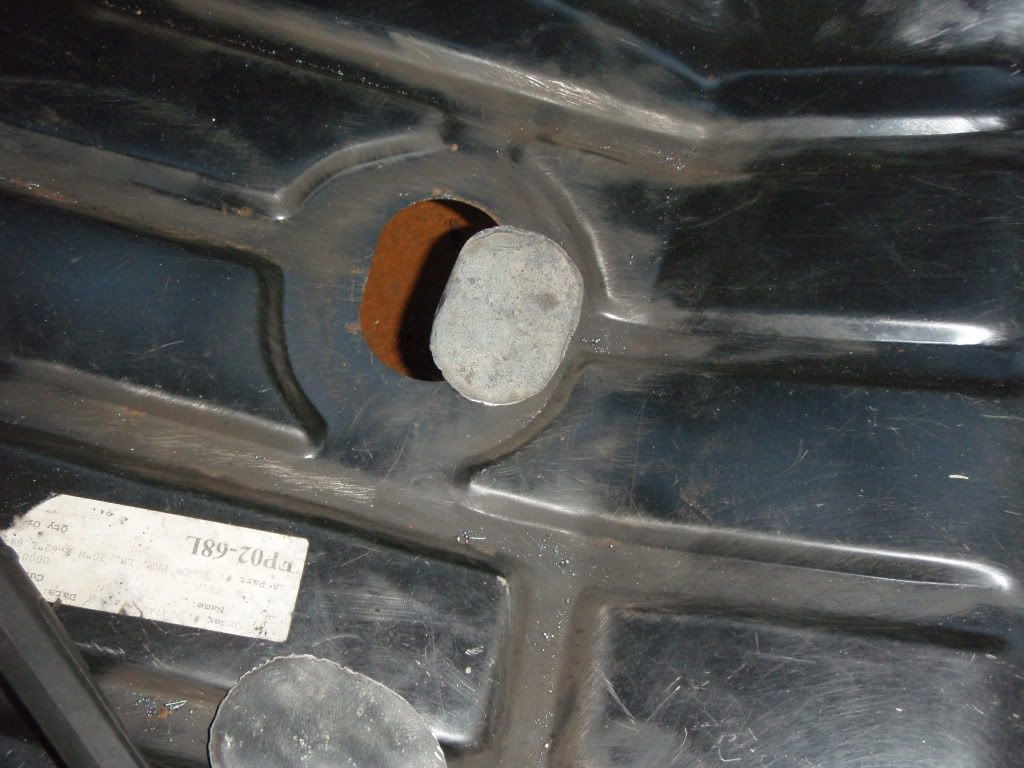

The old floor under the pedals was rotted out farther than the new pan went so I decided to piece it in
moved on to those stupid "drain holes?" extra work awesome! :bored:
