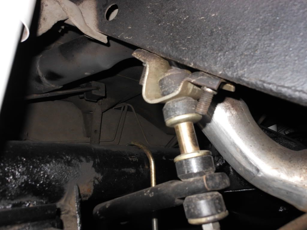

I snapped some pics of where the end links meet the frame. Hope they help.
Good luck!

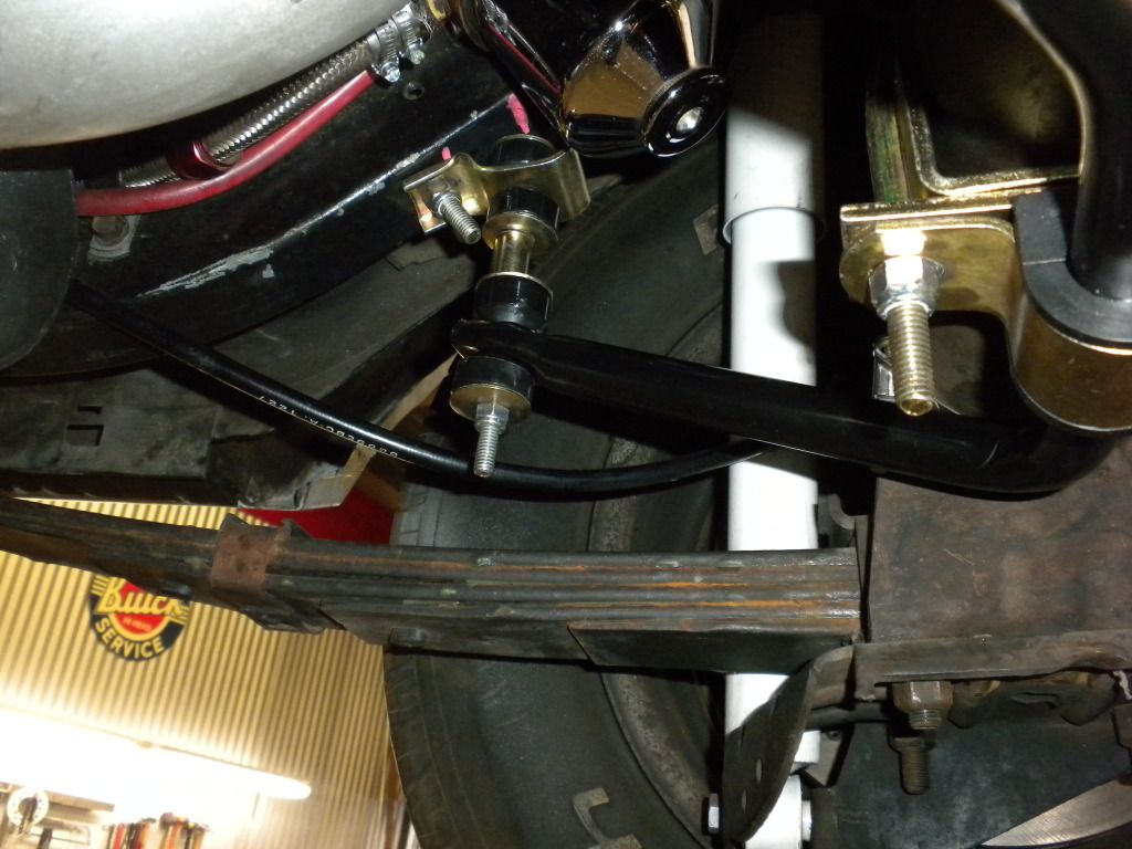

Addco rear sway bar on my 72. Hope it helps.
Right side ;
Left side;
From the back;
3
