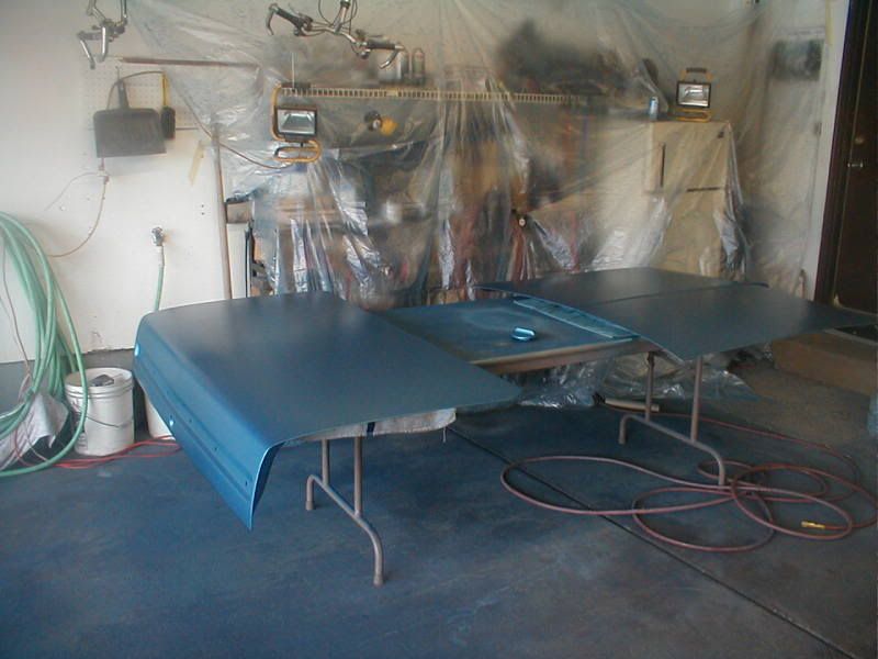

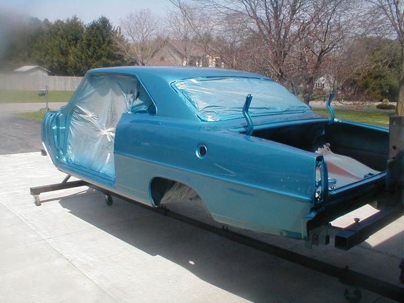

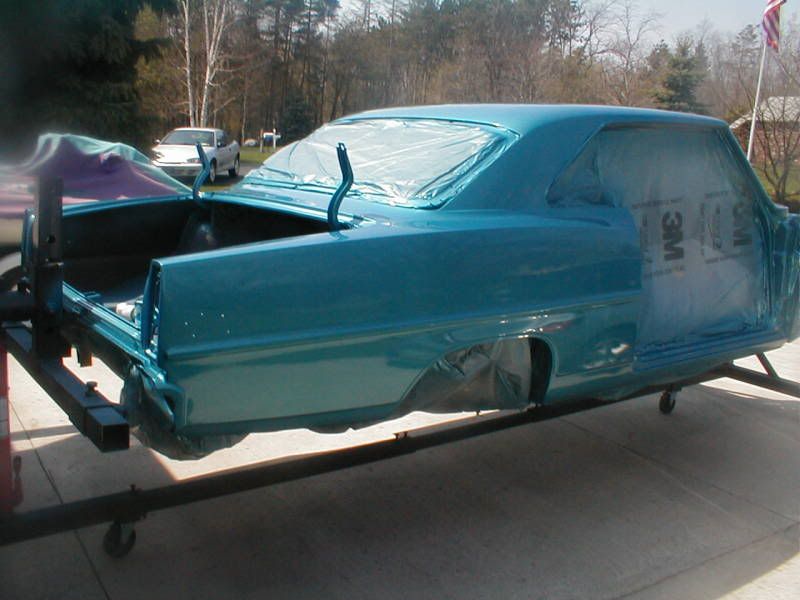

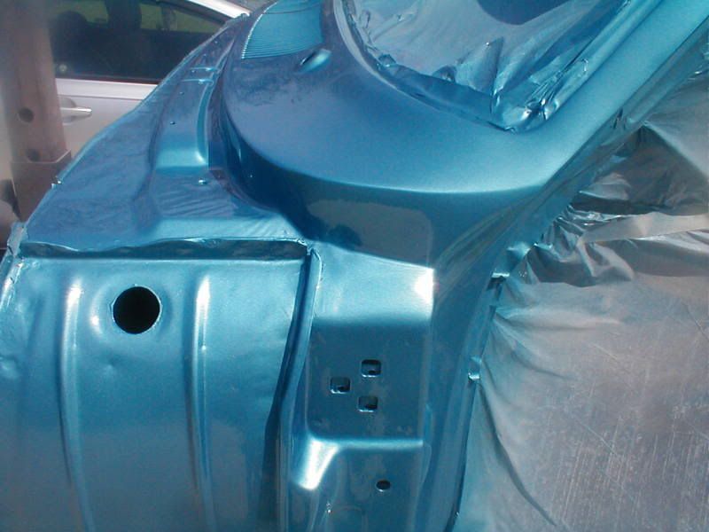

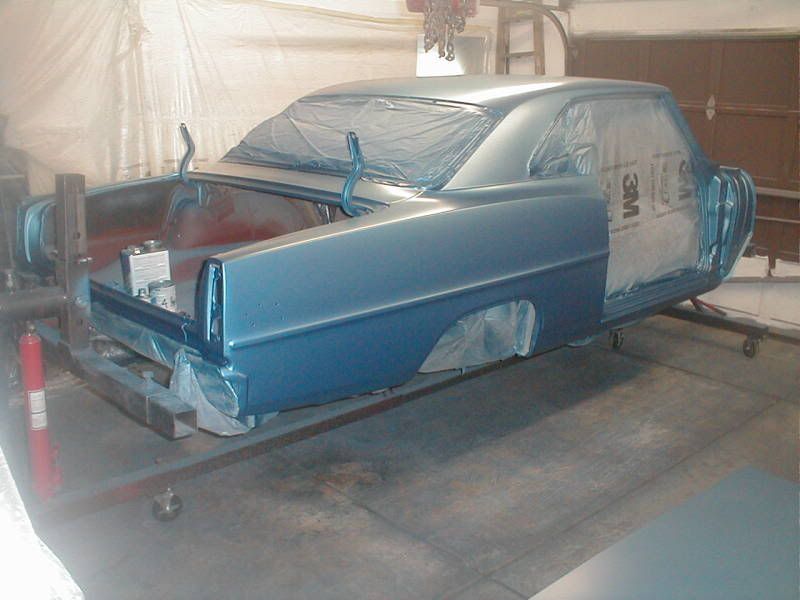

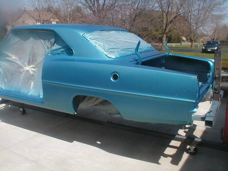

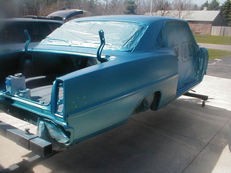

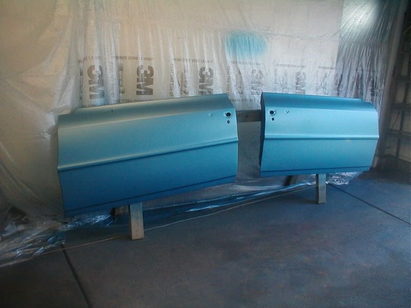

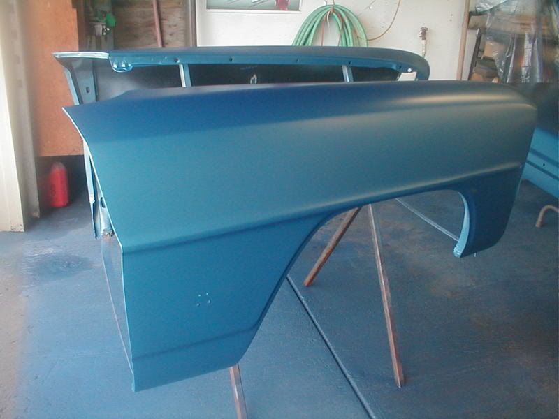

Hello Everyone, Well I painted her this weekend and I am very happy with the Sherwin Williams Ultra 7000 base and clear. It was a pleasure to lay the base down on Friday and have a window of seven days to lay the clear on. I was able to clear on Saturday and Sunday and will finish up tonight under the trunk lid and inside doors. Enjoy!
Without Clear
With Clear Coat

Thanks, I was nervous at first to use the Sherwin Williams House Paint (Only Joking) I mean Auto paint over the Dupont products I have always used but now I am so glad I tried it. I love the seven day window for the clear because you don't have to rush everything into a one day shoot And if there are any problems like a BUG :eek: you can repair it before shooting the clear. :yes:

Yes, the garage is attached but there is a magnetic seal around the door. The garage is fully insulated that helps seal out the smell. Why not tape off your access door when you paint. I also used a freinds brand new HVLP gun that was wonderful. The clear coat went on OK but the lighting hurt me because clear is so hard to see I have some runs :mad: But! the nice part is I sand and buff the hole car to a mirror finish anyway :D
