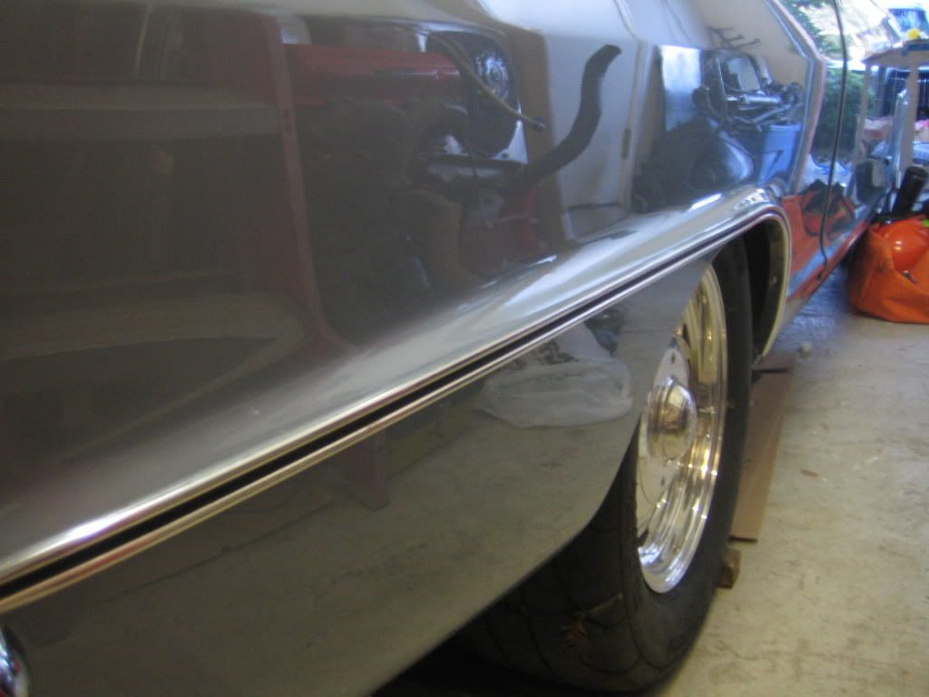

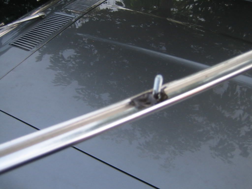

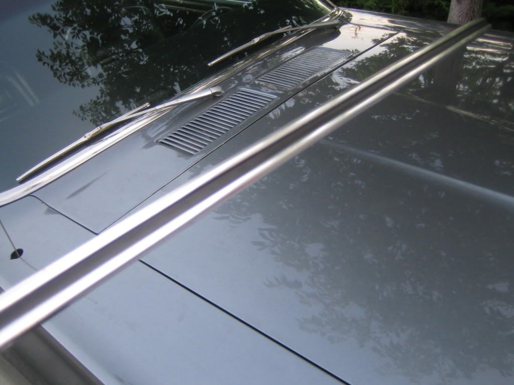

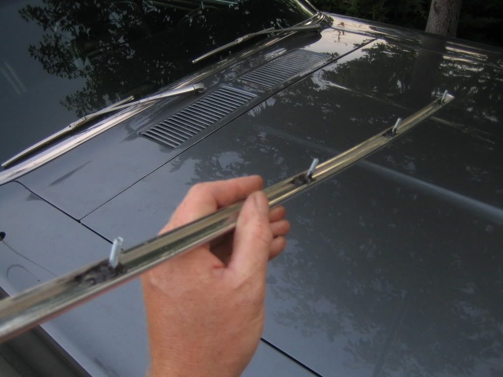

So I bought the repop plastic clips to mount the extensions to the body but they do not work, not even close. I decided to JB WELD some machine screws to the inside of the trim since I can access the inside through the trunk to thread on some nuts. I worked really well.

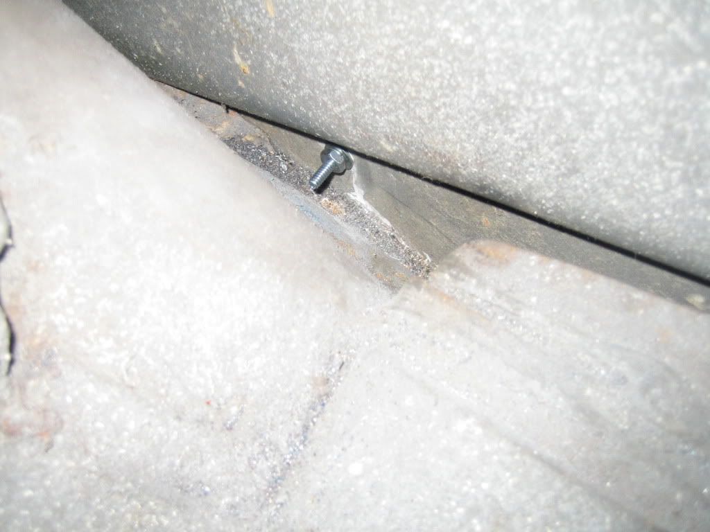

A dab of caulk around the bolt studs before installation will seal it.
Be sure to vacuum those savings out of the trunk. They will rust, and eventually rot out the fender too.
