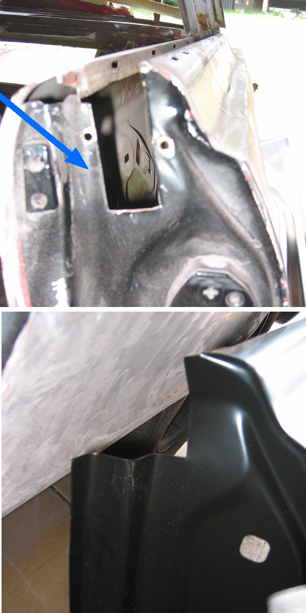

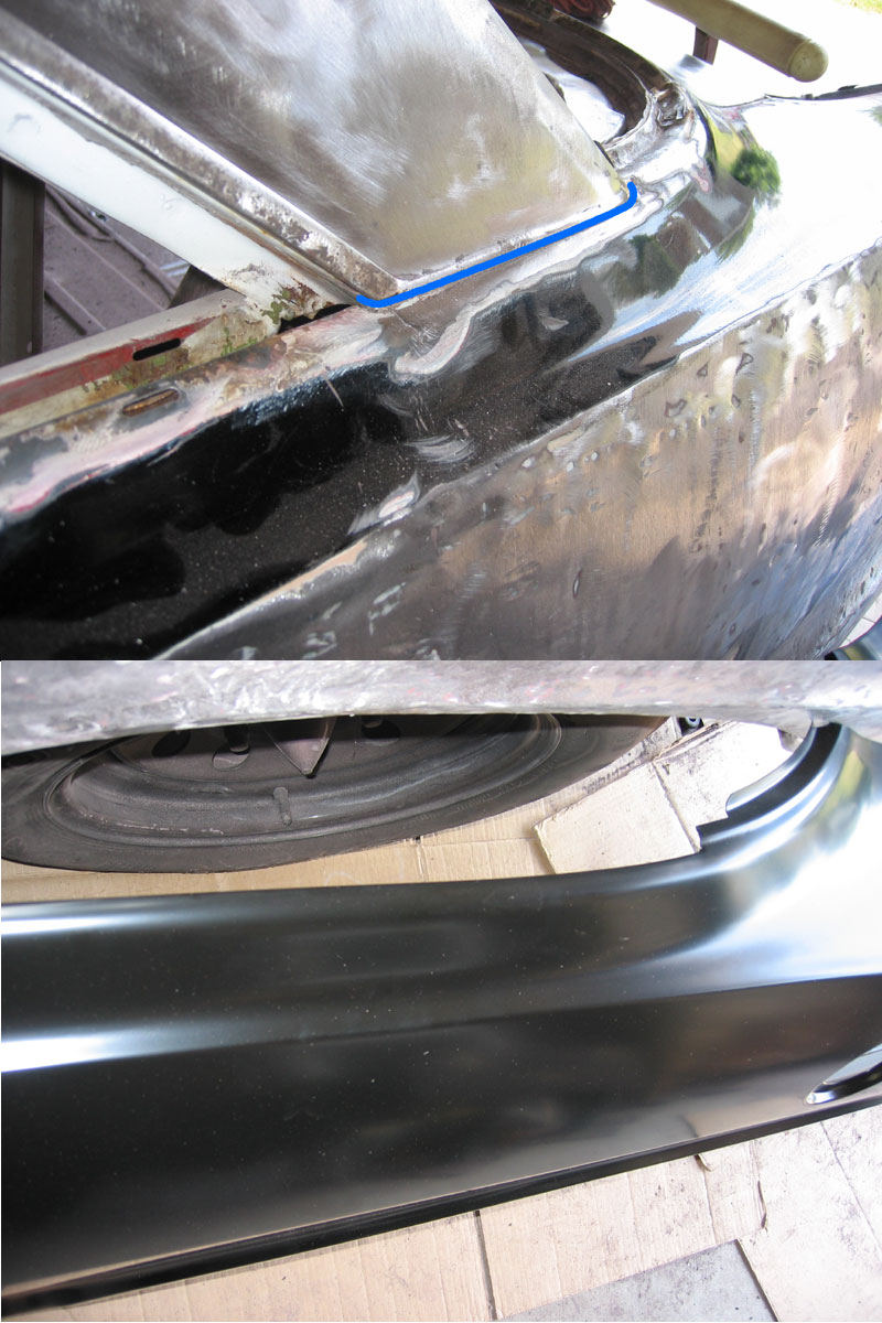

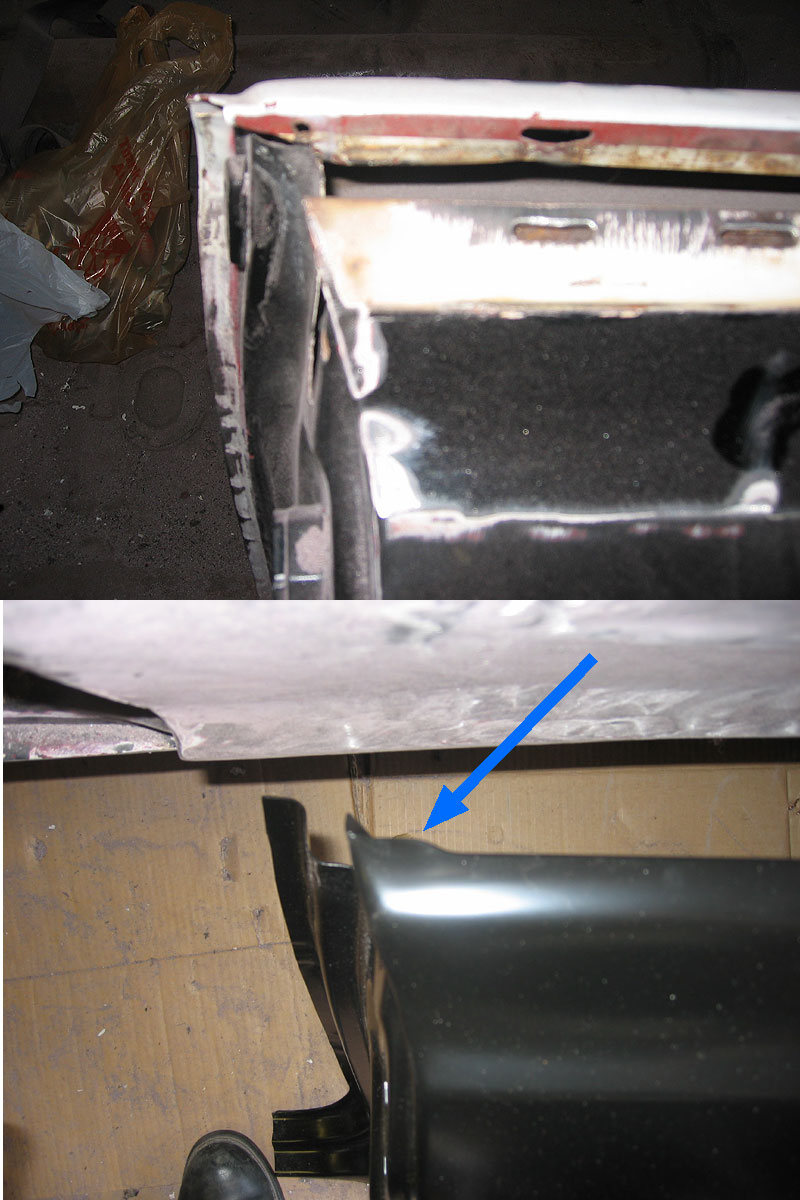

I got a pair of full quarters for my 63 hardtop. As expected, there are some pretty annoying flaws in them. So, for the benefit of any who are thinking of doing the same, here's what you get:
In the first pic, you can see that the factory quarter has a long shallow indentation in the top edge to accomodate the sail panel. Not present in the repro.
The second pic shows this weird little bump or outcropping at the very front corner of the window opening. To my eye, this looks like it is exactly the width that the sail panel notch should be. :rolleyes: Just speculation on my part, I am not a body man, but it looks like it would make the whole window opening too wide if installed as-is.
Also, take note that the inside part of the window notch is completely missing on the repro. Shouldn't be a problem for most people, just don't go cutting anything until you have the new part in front of you.

Damn that makes me wonder if I should bother. I was hoping to be able to just pull it off and slap a new one on without much work. Are there holes for the door latches?
5,820 Posts
Discussion Starter · #3 ·
Yes, you can see one of them in the bottom pic. As for the overall shape of the quarter panel, it seems pretty good, though as is common with repop sheet metal, details like the rear corner tips, right next to the tail lights, are not as sharp as the factory versions. A trained eye would definitely be able to pick them out on a finished car.

Of note for convertible owners, the repop quarters I've seen say they are for coupes only. Anybody know if convertible quarters are available now? Actually, the absence of the sail panel lip in the above pics almost looks like this quarter is for a convertible. Also, the door jamb window notch on the convert is only about an inch deep. I agree with George! With today's technology, they should be able to make perfect reproductions. Unfortunately, very few repop products even come close.
I think it would be very obvious if there was 1 original and 1 repop. could you hammer it to make it pointier, or maybe weld in a little metal?

Have you gotten back to the point of reinstalling your quarter windows? That's my biggest concern. If I'm right, the weatherstrip is not going to make contact with the quarter window, due to the wider gap. Also, because of the missing inside notch area, you're lacking the inner doorstops that go there.
Nope, I haven't put glass back in the car, or painted it yet for that matter. I have straightened out the missing notch but only on one side. I think I measured the width of the 1/4 window opening at one time and it seemed to match with some measurements that were posted when Duane was asking for members to get some numbers off of their cars for him.

You'd have to be a skilled metal fabricator, but it could be done. I'd be hesitant to build up the corners with filler. Seems like it would be too fragile. Crazy thought - what about panel adhesive? Would it be durable enough to be used in this way? Maybe one of our resident body techs will speak up.
